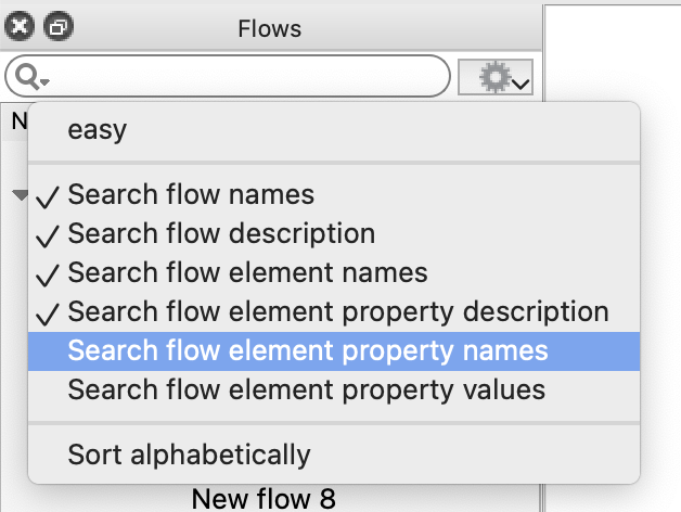

I usually do this by using the search in the flows pane. Depending on what you search you might need to enable some of the options:
Screenshot 2023-02-17 at 13.52.30.png (97.58 KiB) Viewed 10042 times
(The more enabled options and the bigger your flows, the slower the search will be)
