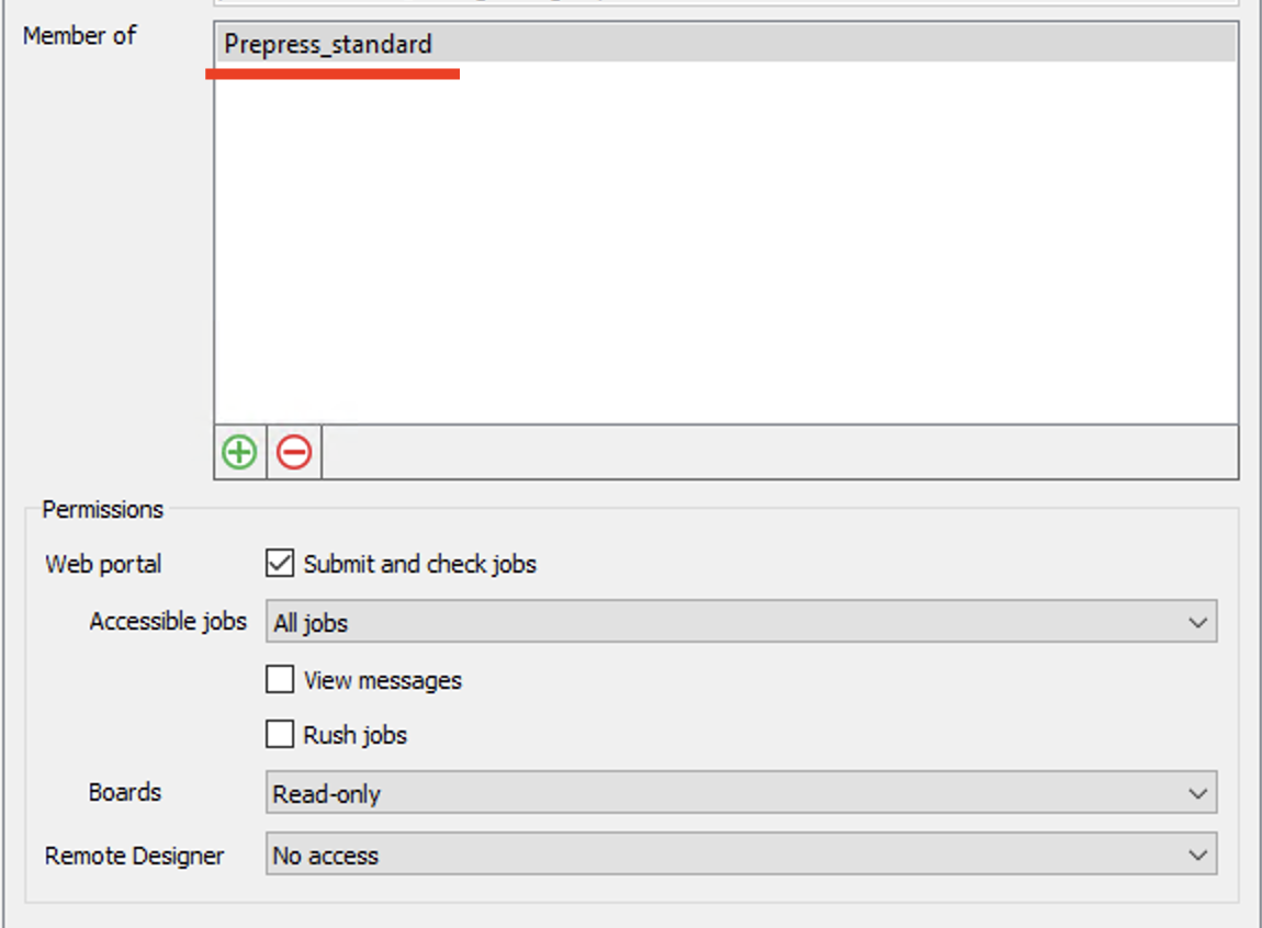

Hi, is there a variable for Switch User Group that I can use in my flow when a job i submittet from a Submit Point? In this case I would like to use this information for a external dashboard.

Hi Magnus,
You have the [Connection.UserName] variable and with the app Row2Variable you could set it up to get the group as PrivateData.
Might work for you.

Hi Jan, yes I could do my own mapping (user to group) with Row2Variables but I was hoping that the data was already in a variable. With an external mapping I have to remember to update the table whenever I do a change or add a new user.

Hi Magnus,
I was also interested in a such solution, but never found a method to do it in an elegant way...
If you have scripting module/database module you could access it via the .\Enfocus Switch Dataroot\settings\UserDatabase.db3

tdeschampsBluewest wrote: Wed Mar 08, 2023 12:04 pm Hi Magnus,
Thanks, unfortunatly I doesn't have the scripting or database module.
