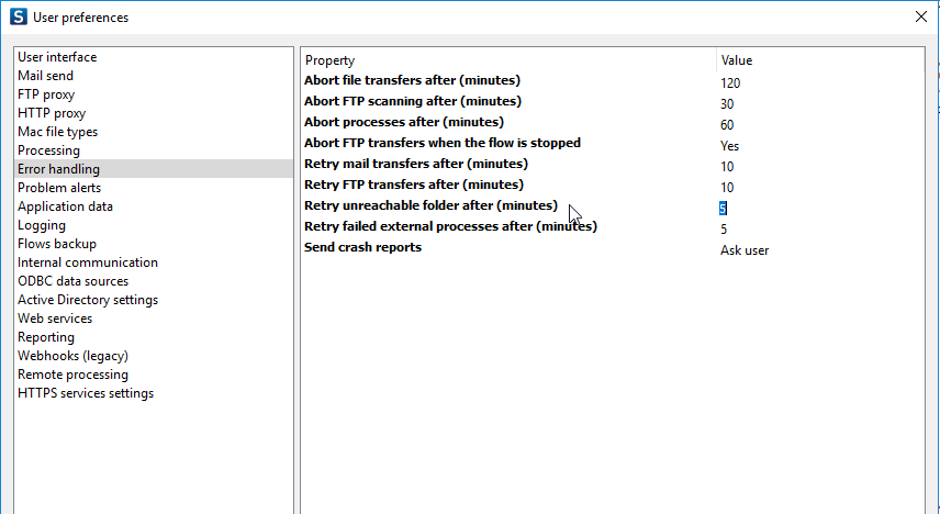

We had a similar issue when we installed this app. (Using v2.0 with Switch 2021 Fall) Reached out to the dev and they suggested we check our Switch preferences. You can set Switch to retry after an error.
Under [Error handling > Retry failed external processes after (minutes)], make sure you've got a value set there. We set ours to 5 min and haven't had a problem since.
Hope this helps!
Hope this helps!
- Preferences.png (19.26 KiB) Viewed 9701 times
