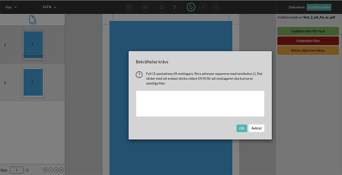

My guess will be to setup a new review button : "Send to" with a mandatory comment where the reviewer MUST put email(s) address(es).
Once you have this comment in metadata, you can use string/replace app to update the mail in the metadata, and loop once again trough PDF review.
Since we can't enforce the comment syntax with a regex, it need to be handle with care as it will break very easily with end-user.

That is almost exactly how we have solved it today. But since we changed the information text (in the language-files) we cannot use the comment feature as intended for other buttons.. And as you said, since we can't use regex we have alot of failed email-address-formatting
If Enfocus added the feature to configure you own "text fields" and allow the use of regex in the said field that would solve our needs.
