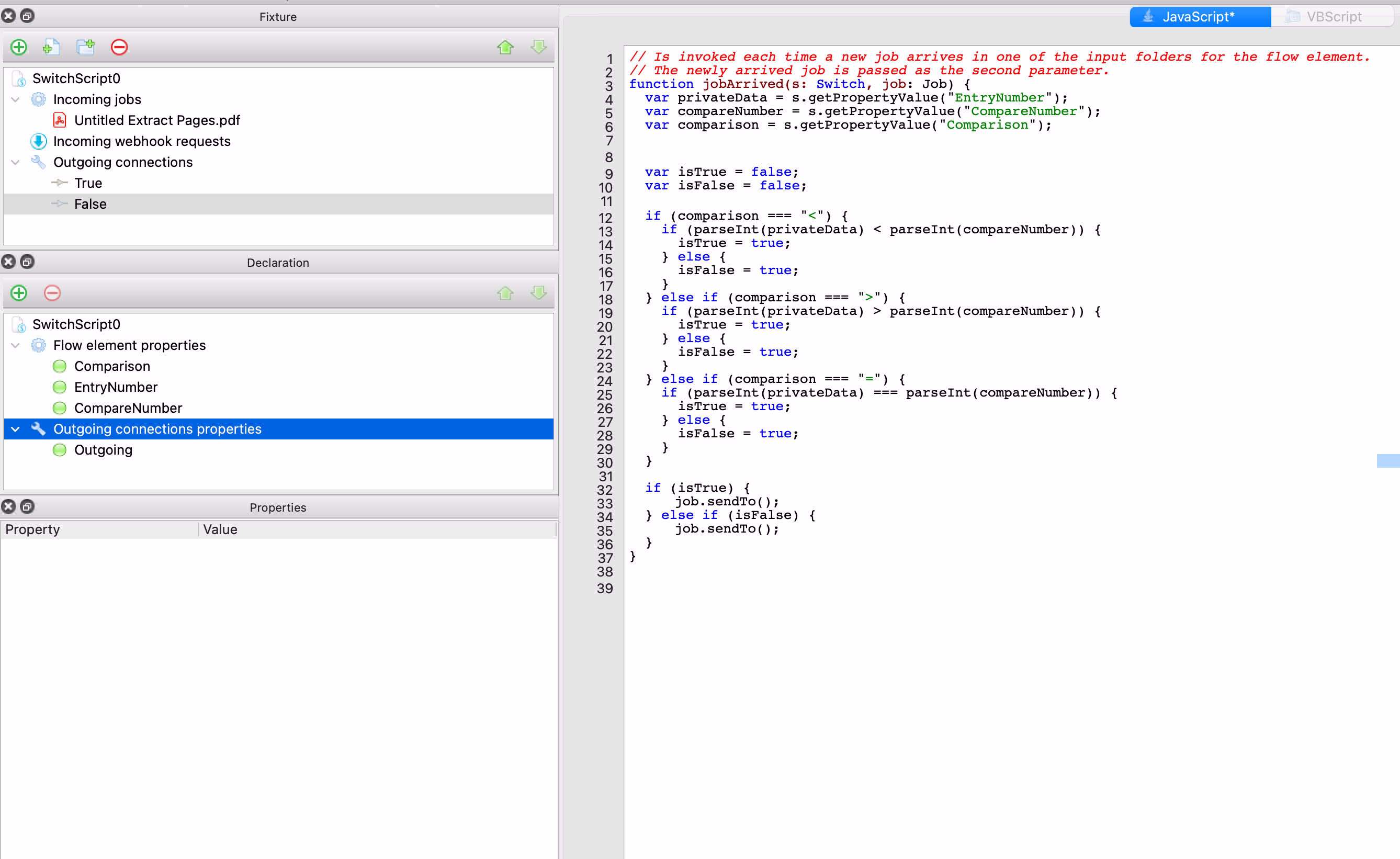

Hello,
I'm new to using the SwitchScripter and I'm trying to create a script that will allow the user to input to numbers and select a comparison of ">" or "<"
and send the result to the connection that has the outgoing connection property of "True" to one connection and "False" to the other connection based on the result - Again excuse my newness :D :D
I was trying to use the job.SendTo() but I don't think that is the way so I have it
Current Code:

Current setup in SwtichScripter.
Screenshot 2023-04-19 at 9.32.58 AM copy.jpg (231.77 KiB) Viewed 36159 times

To send the jobs to an Outgoing connection that has a certain name you'd need to implement some logic like this:

Thank you. This definitely helps.. Seems best to leave them generic. I do want to be able to select on the outgoing connection of True or False and use that to route them unless you feel it should be done a different way via Traffic light or similar? Just trying to figure out best practices.

I'd recommend using traffic light connections either that or have a single outgoing connection and set a true/false value as private data which you can evaluate further down the flow
