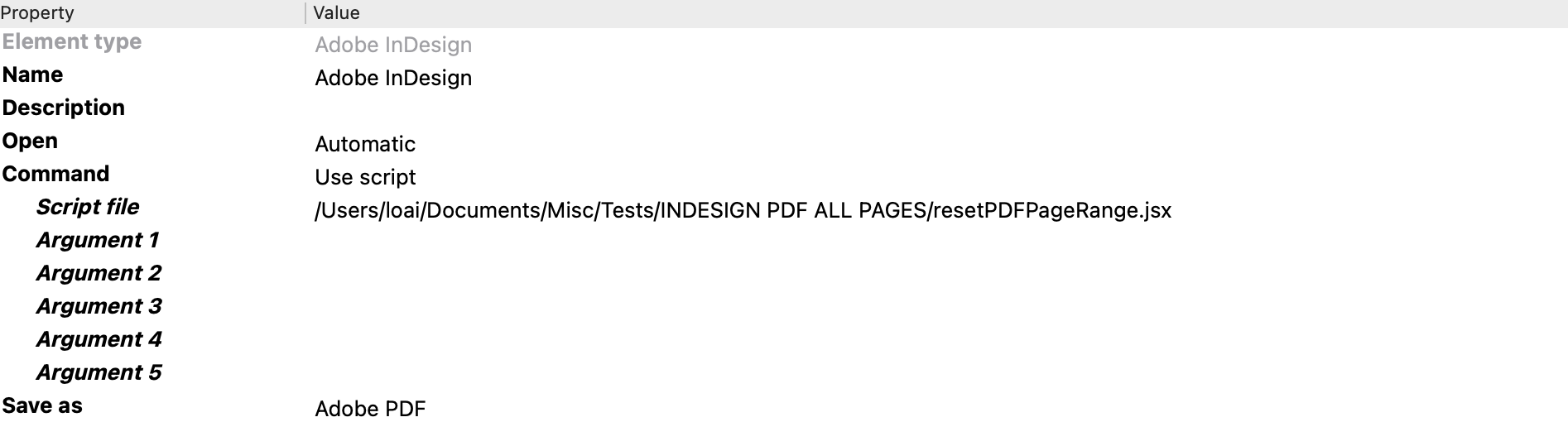

What you can do is executing a small InDesign Script before the PDF export so it resets the page range parameter to "ALL PAGES"
Screenshot 2023-04-21 at 22.43.17.png (92.7 KiB) Viewed 26788 times
And the jsx script is this one liner:
app.pdfExportPreferences.pageRange = PageRange.ALL_PAGES;
HTH

Thanks Loic, it's working great!
