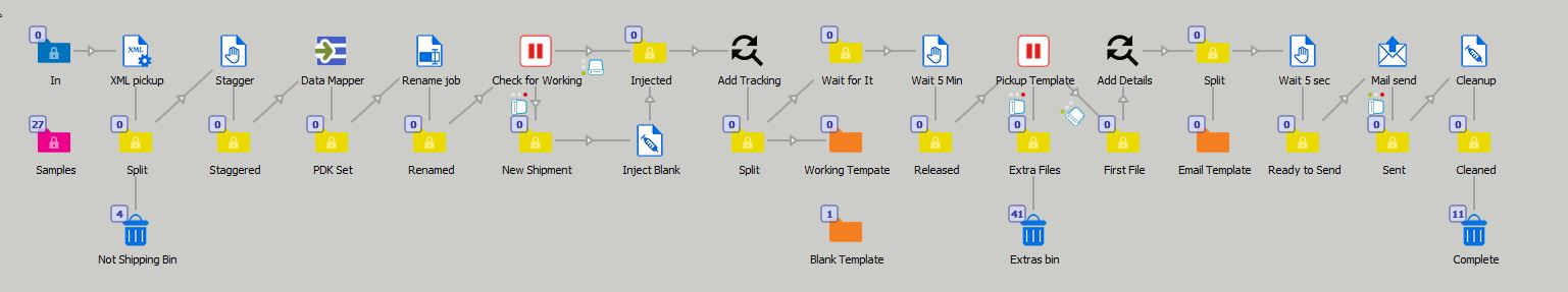

I was able to get this working by spreading out the xml files, grabbing an html template, and using string replace to add in the tracking links. After a few minute wait, I use the html template to send the email, then delete it. If anyone has a similar need, PM me and I'll send you a copy of the flow.
- Shipping Email.jpg (45.36 KiB) Viewed 11922 times
