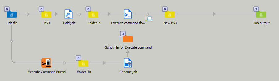

Re: Get one layer from Imagemagick
This works for me with the BAT-file created with the app "ExecuteCommand friend"
This is my BAT-file, you can add more variables if you want.
Flow looks like this since we have to save the BAT-file for execute command to pick it up. It will be over written with the next job.

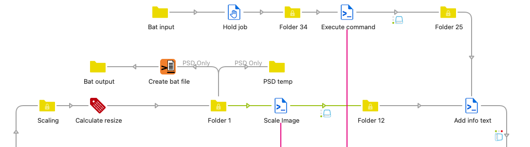

Hi Jan!
How does your execute command look like? Command or path and arguments?
I create a bat file with Execute Command Friend and it looks like this and i think it is correct.
set filename=%1
set output=%2
C:/Program Files/ImageMagick-7.1.1-Q16-HDRI/magick.exe C:/Users/Admin/Roaming/Enfocus/Switch Server/PropertySets/12/PSD_Files/%filename%[0] -resize 1772x1772 -sharpen 3 %output%
The bat file is saved as input filename .bat and placed in a temp folder, the psd file is also placed in a temp folder. When picked up by switch i run a execute command where i try to use the bat file, maybe this is not the correct way?
set filename=%1
set output=%2

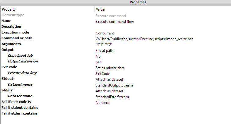

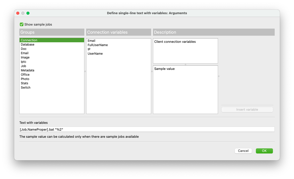

Here is the settings.
The %1 variable that Execute command uses is the full path to the incoming file. So you just set it up as in the attached screen shot and it will work for you.
