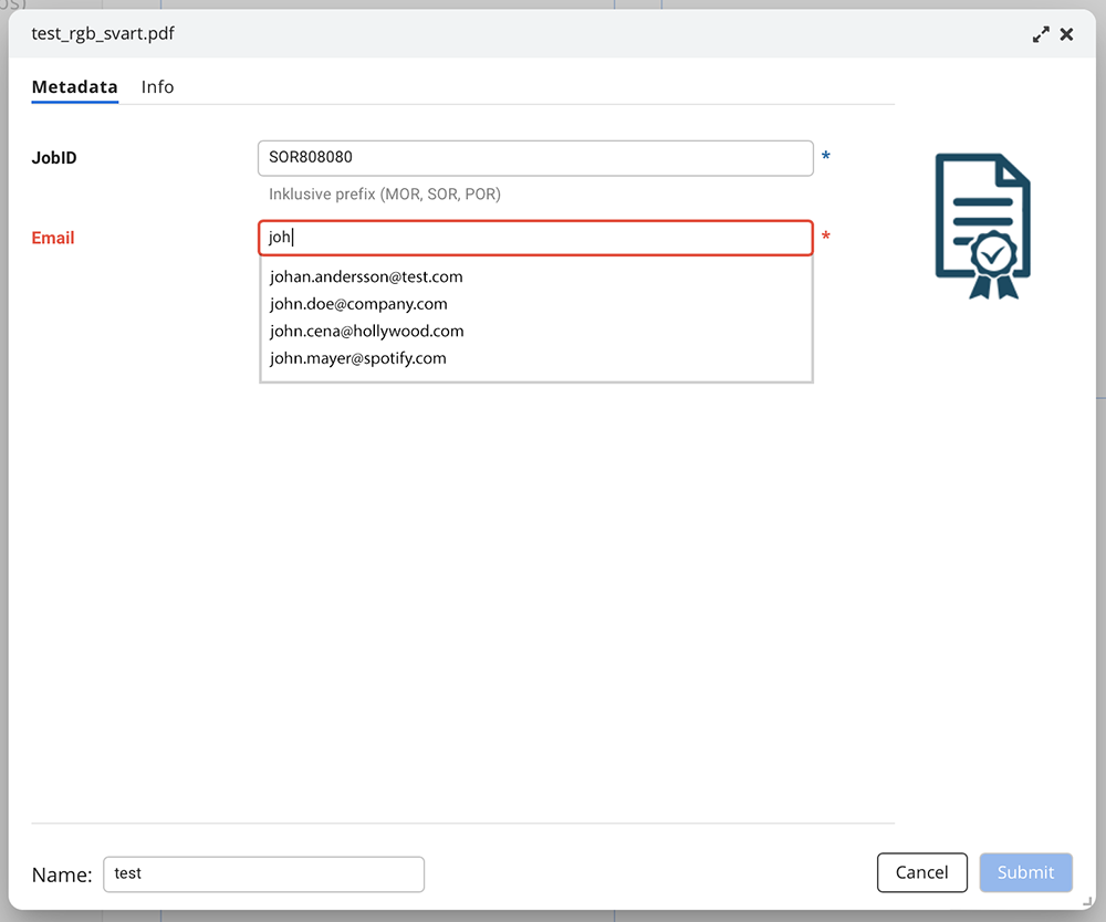

Hi, is it possible to to implement autocomplete in a metadata field in a submit point some how?
In this case I would like to show suggestions of previous used email-addresses when you start typing, like this:

JBoyd1976 wrote: Thu Jun 15, 2023 11:15 am When you use Dropdown List for your data field and you list all the emails available, the user will see the full list when they click the dropdown field but if they start typing the list will shrink and only display the values that contain the letters you are typing.
So you could have a list that contains 50 emails, but only 2 emails contain the name john. When you click the field and type john, you will only see those 2 emails. This is part of the functionality of switch
Yes, but if the email address/addresses is not already in the list that approach doesn't work. In my case the user should be able to type any email address. And I would like the autocomplete list to grow when new addresses are added.

freddyp wrote: Fri Jun 16, 2023 11:24 am In the submit point metadata you can type a value that is not in the dropdown and submit, so I thought it would work, but unfortunately the value does not make it into the metadata.
As a workaround you could have an additional field "New mail address" that the user uses when the mail address is not in the dropdown. Not perfect, but better than nothing perhaps?
Ok, to add another field kinds of ruins the whole idea of a user friendly UI, then you first need to try the drop down field and if nothing comes up you need to fill out another field..
The experience we want to simulate is the one when you are writing a new mail in Outlook and start typing a name in the TO field.
