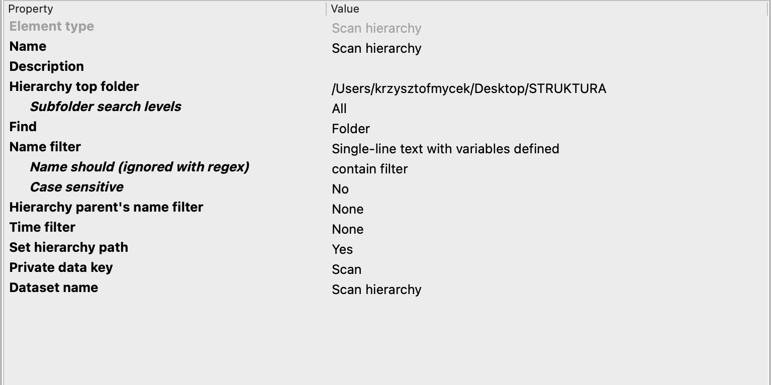

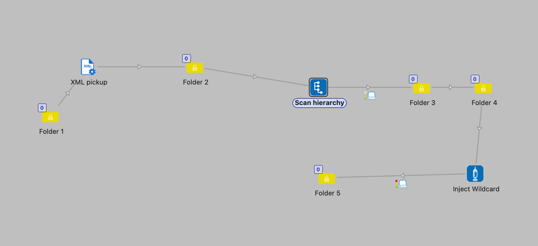

My solution is in Scan hierarchy and Inject Wildcard
But thank You for your help
