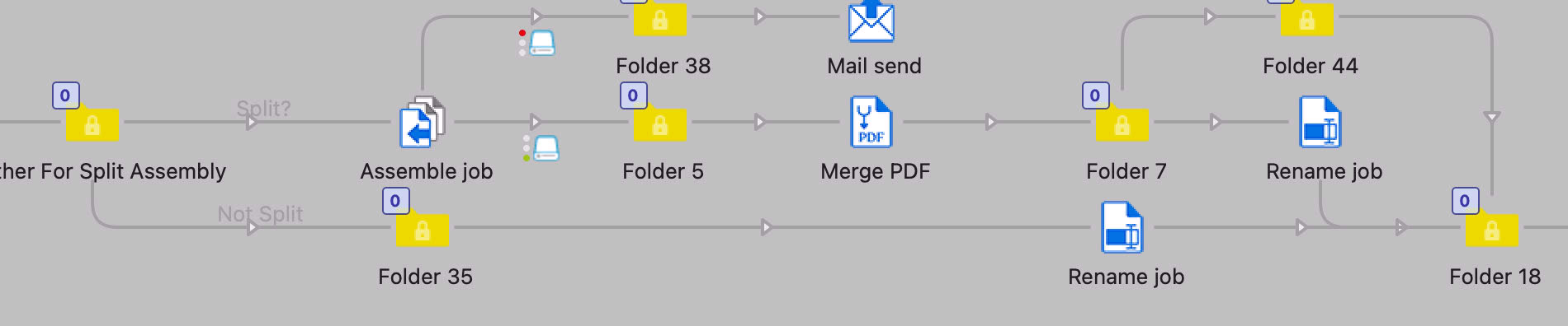

We had a similar issue when we were splitting PDF by tray for mailing and the file were imposed outside of switch, it could be 100's of files waiting as part of the job that as split to assemble back.
We would group the split pdfs (Split by a script), then ungroup to get the PD key of the group and use the Ungroup.NumFiles to add as a Suffix '_Parts[Ungroup.NumFiles]'. The files would have the range of the split in them long with the number of files suffix, then would then leave switch for a 3rd party imposition.
File name example : 12345_test_00001-12009_Parts2.pdf ; 12345_test_12010-14000_Parts2.pdf
As the files came back into to switch I used the after "_Parts" as the assemble number and use the job number prefix we added the name of the files as the Job Identifier.
Once the condition was met they would assemble and we remove the 'Parts" and page range info and off it goes to press.
If they didn't get all the parts, it would go to the fail connection I would capture files that output and email them so it was easy to see what part of the group was missing.
