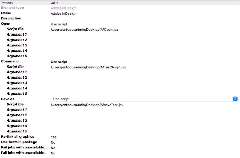

jan_suhr wrote: Fri Sep 01, 2023 5:08 pm You have the options in the InDesign elements properties
InDesign elements properties, are you saying this PFA
If yes. I have a doubt. Now If I open (Script) a document and keep it as activeDocument (consider 123_XXX_v1.indd) add all my required info copied into the InDesign from the command option (Script), and save the file in the save option. Now how I can retain the "123_XXX_v1.indd" or keep the file inside the flow?

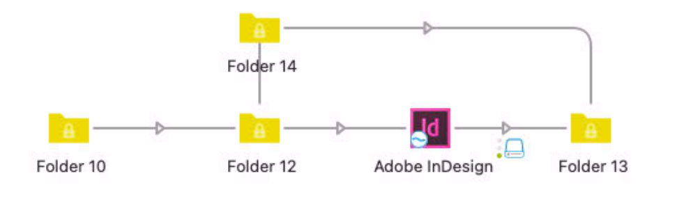

Post by jan_suhr »
In one folder before the InDesign element you add one folder besides the InDesign elemet and drag a connection to the new folder and you will get a copy of the file in that folder.

jan_suhr wrote: Fri Sep 01, 2023 6:05 pm In one folder before the InDesign element you add one folder besides the InDesign element and drag a connection to the new folder and you will get a copy of the file in that folder.
What you said is for keeping a copy of the original file in the flow (PFA, am I correct?). But I have a JSON condition that loops for a single activeDocument! suggest me on this case

Post by jan_suhr »
Easiest solution is to split the JSON into each part for each file. Then that JSON file runs the InDesign document.

jan_suhr wrote: Fri Sep 01, 2023 6:35 pm Easiest solution is to split the JSON into each part for each file. Then that JSON file runs the InDesign document.
hy That's a nice workaround, but I don't want to make any changes to the existing script so I going to try this way.
Initially, I will do the saveACopy for the .indd file with loop data in an outside folder (Foldername: Original output) using the Command Option and then a dummy save to move the .indd file to the out connection (save option)
