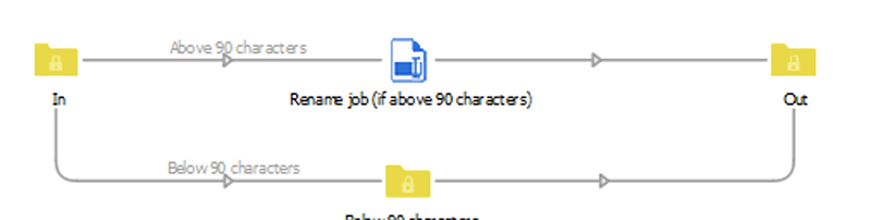

Re: Length of variable
Posted: Thu Sep 21, 2023 11:50 am
by magnussandstrom
I have done a similar thing, similiar to Freddys idea. Maybe this helps:
Posted: Thu Sep 21, 2023 2:23 pm
by JimmyHartington
Thanks Magnus for the example.
In my current use case I will use the other idea with scaling the content, which overlaps the media box.
