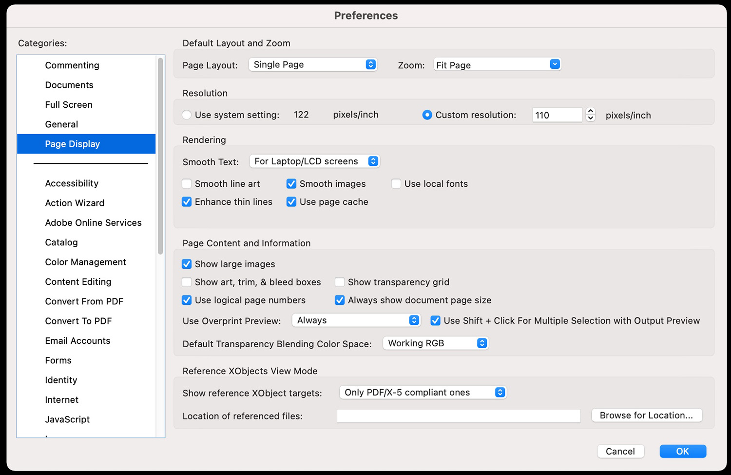

The one thing that isn't fixed with the new Pitstop v23.0.1.0, is the "always on" ability to see the document size in the lower left hand corner. You can still hover the cursor over it to see the media size as before but must disable the Page Display > "Always show document page size" in Acrobat preferences. We are running macOS Big Sur v11.7.10. We have at least 15 users reporting this issue. Also another issue plaguing us for a while is when customizing the tool bar and restarting the application. we loose the customized tool set. This has been going on for quite some time, Some users aren't noticing this.

CruzinCooler wrote: Wed Oct 04, 2023 3:53 pm The one thing that isn't fixed with the new Pitstop v23.0.1.0, is the "always on" ability to see the document size in the lower left hand corner. You can still hover the cursor over it to see the media size as before but must disable the Page Display > "Always show document page size" in Acrobat preferences. We are running macOS Big Sur v11.7.10. We have at least 15 users reporting this issue. Also another issue plaguing us for a while is when customizing the tool bar and restarting the application. we loose the customized tool set. This has been going on for quite some time, Some users aren't noticing this.
It appears that those issues are strictly related to Acrobat. I wasn't completely sure yesterday and needed to check but i can confirm, it's not related to PitStop whatsoever. You may want to join Adobe Care or to report those issues here:
