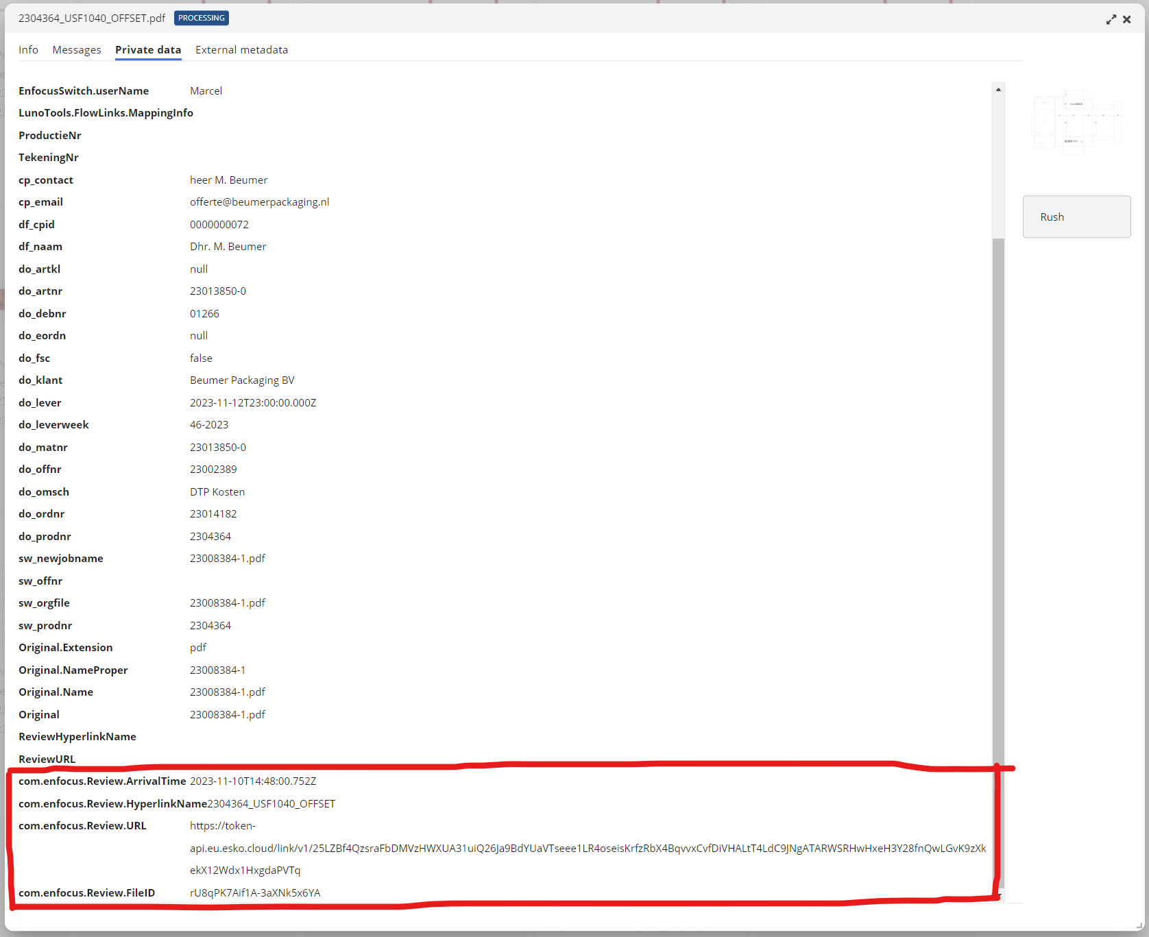

Is there some way to get access on the private data after the job is reviewed?

You can always extract the private data before the job gets to the final output folder of the flow, even after the file is reviewed.
For example: [Job.PrivateData:Key="com.enfocus.PDFReviewModule.FileURL"]

I want to send a notification email incl. the review url and link name that the proof is reviewed to the customer. But after the job went through the 'reviewed file' connection, the private data [Job.PrivateData:Key="com.enfocus.PDFReviewModule.FileURL"] and [Job.PrivateData:Key="com.enfocus.Review.URL"] are not availeble anymore.

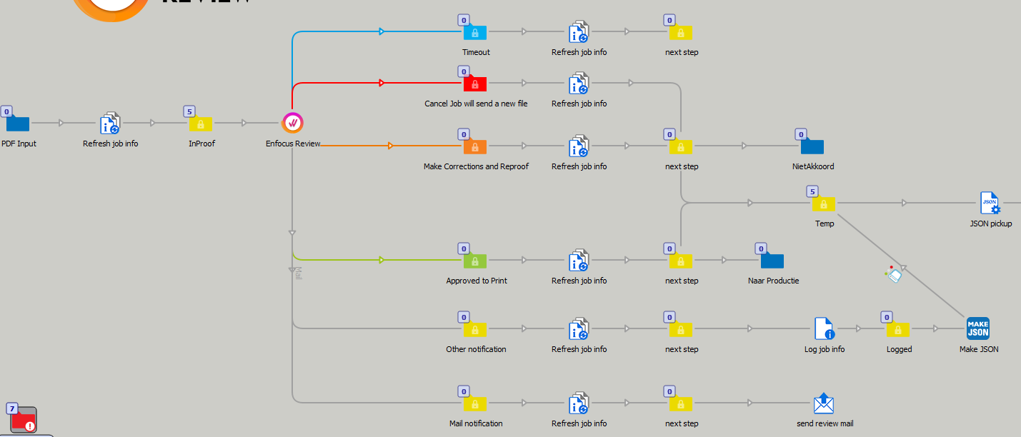

Strange, I did a test and for me they are still there. Could you maybe post a screenshot of your flow?

The private data is available after 'other notification' and 'mail notification' but not after the 'reviewed file' connections
