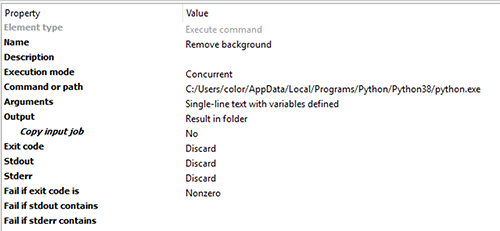

I found an old flow where I executed a Python script with Execute command, here are my settings:
Arguments on this case are:
C:\Users\color\Documents\image-background-remove-tool\main.py -i "%1" -o "%3\[Job.NameProper].png" -m u2net

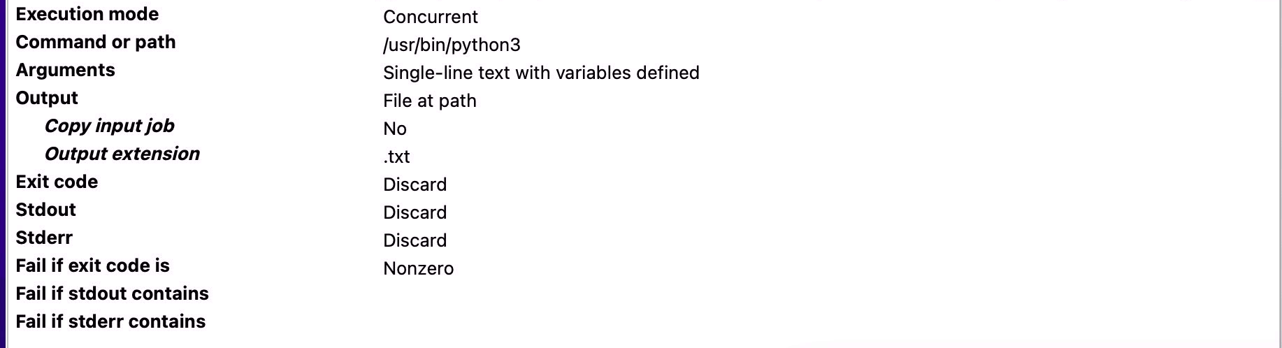

Not sure if this well help but I use Python via execute command to do some data cleansing
I think like suggested, change your Output to File at Path, we also point to Python in the Command and then in the argument we put the path to the script
Here is my setup.
In the Arguments we have the path to the script in quotes, like this: "/Path to script/script.py" "%1" "%2"
Output : File at path
Screenshot 2024-01-18 at 8.50.36 AM.png (188.18 KiB) Viewed 43568 times
