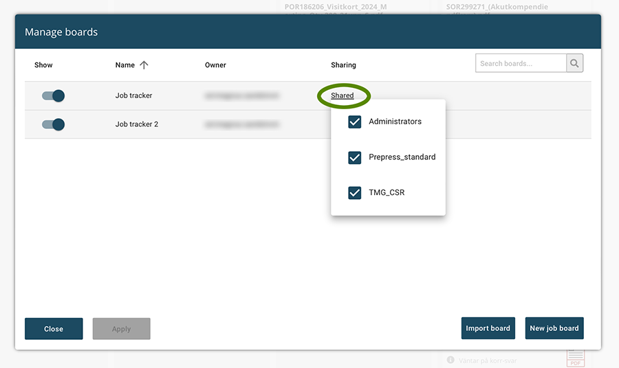

Can job boards be shared with user groups or just the filters? Will each user need to import the specified job board?

Yes, you can do that from Switch Portal (log in as an admin), click on Manage Boards to enter this menu:
