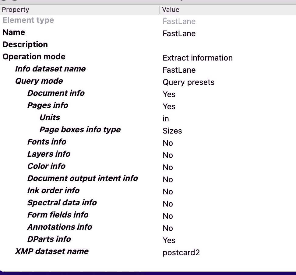

Interesting, could you give me a screenshot of your Fastlane settings?

Sure. They are really basic, only using the presets and traffic lights, although I don't think any file has ever went down the fail path just actually fails to problem jobs.
Here you go!
Screenshot 2024-01-22 at 5.49.52 AM.png (249.05 KiB) Viewed 7147 times

Thanks, what settings are you using in Switch Preferences > Error handling > Abort processes after (minutes) ?

by rhd_ole
It's just the default, 20min. These failures are about immediate, they don't hang out, just fail.
