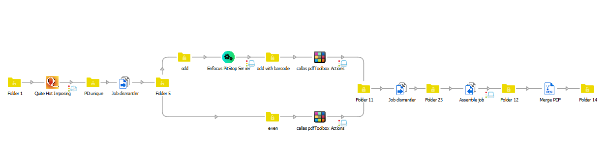

The way i've figured this out after all:
QI splits pdf into two pdfs with only odd and only even pages, I run action on odd pages and then Callas is splitting pdf into separate pages named <firstpage>0 for odd and <fistpage>1 for even. Merge PDF is merging them in alphabetical order so final file is same as input file.
- image (1).png (27.67 KiB) Viewed 16459 times
