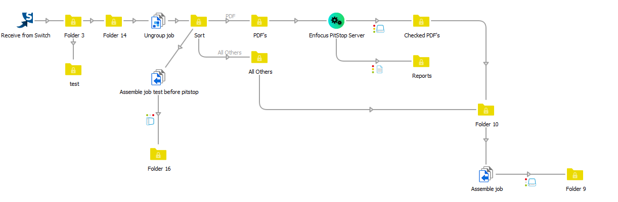

I have a flow where I want to take a folder submitted by a customer with possible multiple sub folders and multiple different types of files. Sort out the PDF's, create a report, then assemble everything back into the original folder structure. I have used ungroup job and assemble job on other flows to do similar things. When I am doing it this time resulting assembled job has all the individual files in a single folder. What am I missing to be able to have the submitted folder structure be the same after assembling the job?
Flow:

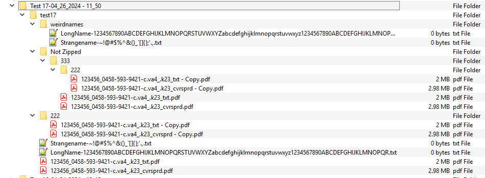

Starting Folder Structure:
Original Folder Structure.PNG (36.58 KiB) Viewed 10287 times

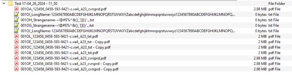

Resulting Folder Structure:
Resulting Folder Structure.PNG (31.42 KiB) Viewed 10287 times
