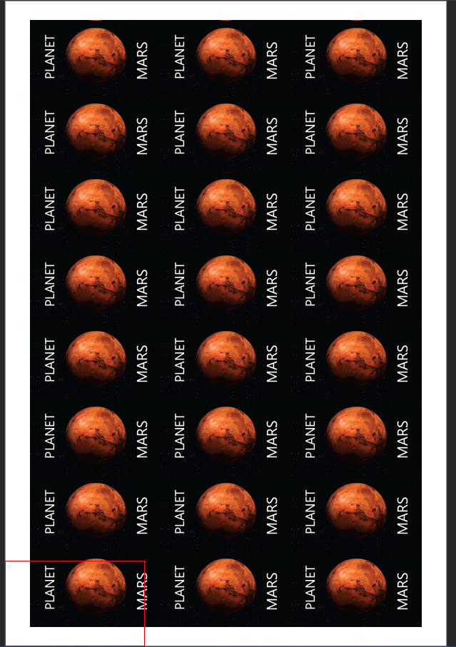

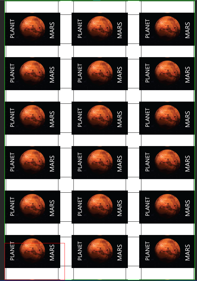

I already managed to solve another problem that I had posted previously, but does anyone know why I am giving this spacing error? I'm doing the imposition in the Pitstop itself, everything is fine including assembly and bleeding, but when I add the cut marks I get this spacing problem, I don't know if the pitstop is for doing this type of imposition or do I have to purchase software imposition, but it's not possible that you can't do this at the pitstop, or am I wrong?

Personally I struggled with doing Imposition with PitStop. Out of curiosity, what RIP software do you use , I'm assuming these are for digital runs?

yes, it's for digital prints, but before purchasing any imposition software I was trying to use pitstop to make the montages but when I enable the crop marks this problem arises, and I haven't found any way to solve it.

Good morning, yes, I understood well, I haven't bought any imposition software yet, I'm doing tests with business cards and flyers to see if it's possible to impose on these pieces, I did it and everything's fine, but I don't know what's going on. What happens with the pitstop is that it is giving this spacing between them, the question is whether it is possible to make the imposition with the cutoff mark using just the pitstop, I will acquire an enfocus plugin focused on imposition, but until then I am testing just what Pitstop offers, but thank you very much for your help.
