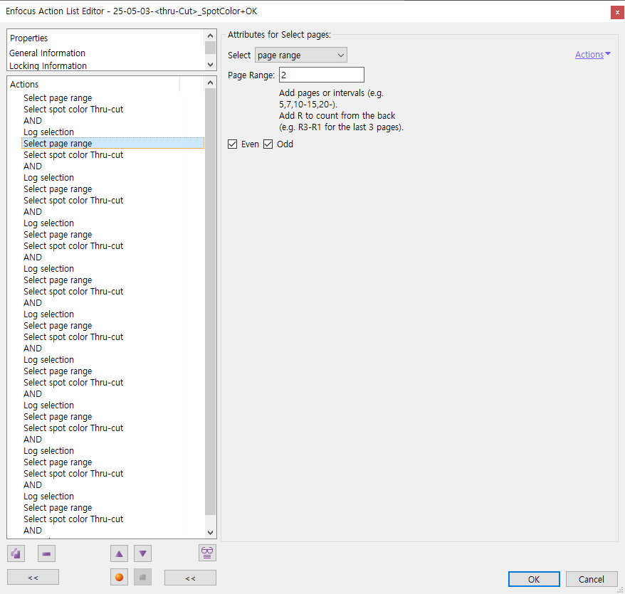

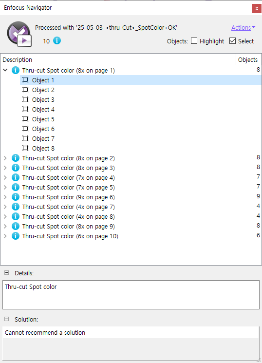

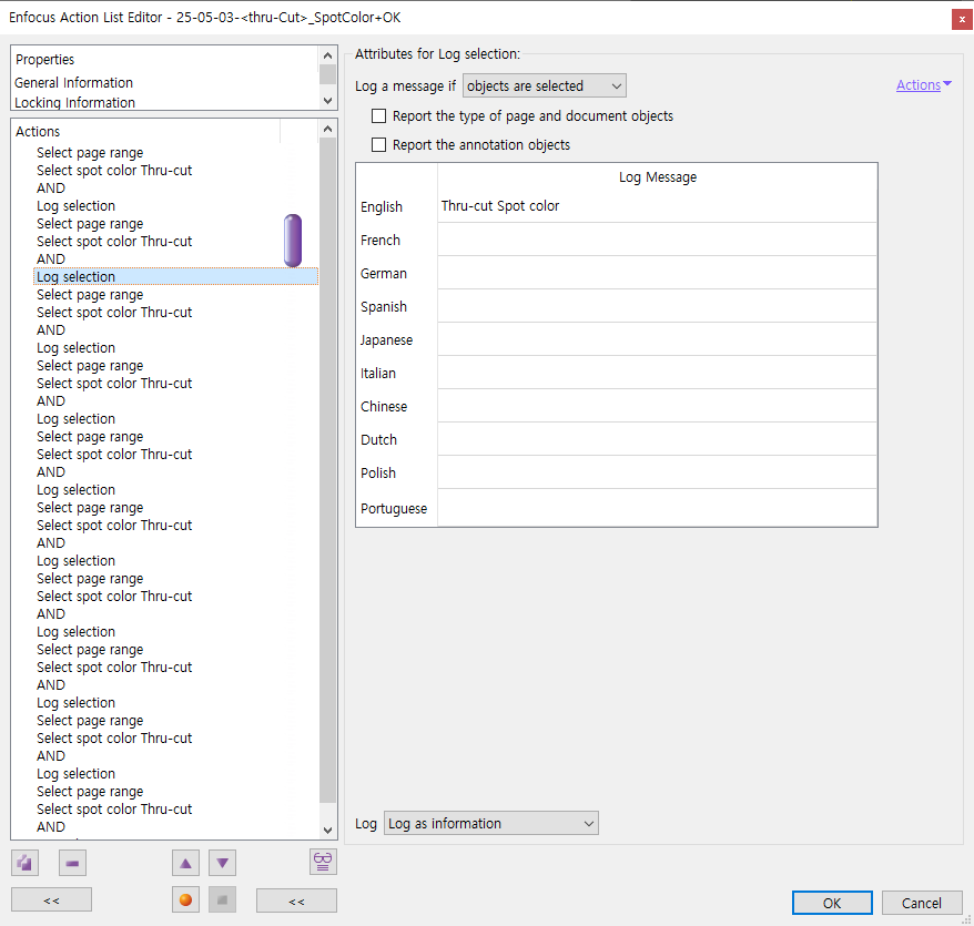

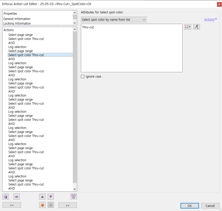

Re: count object...
Posted: Mon May 19, 2025 4:38 pm
by Urraco
It's not bad....works.
You just need to add a 'page range' in the action equal to the number of pages in the document,
or add more than the total number of pages.
Thank you!
