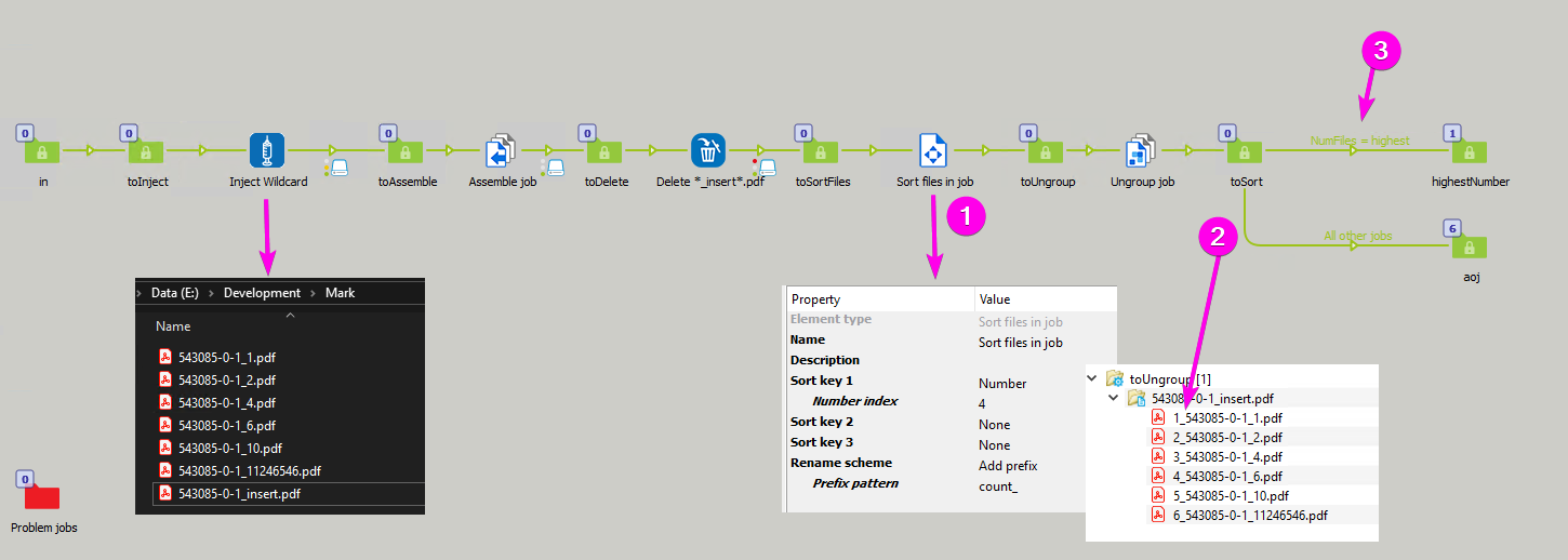

This is not the most elegant way, but for Friday afternoon tinkering.. ;-)
Flow: https://fromsmash.com/_4AVVgUv~g-bt

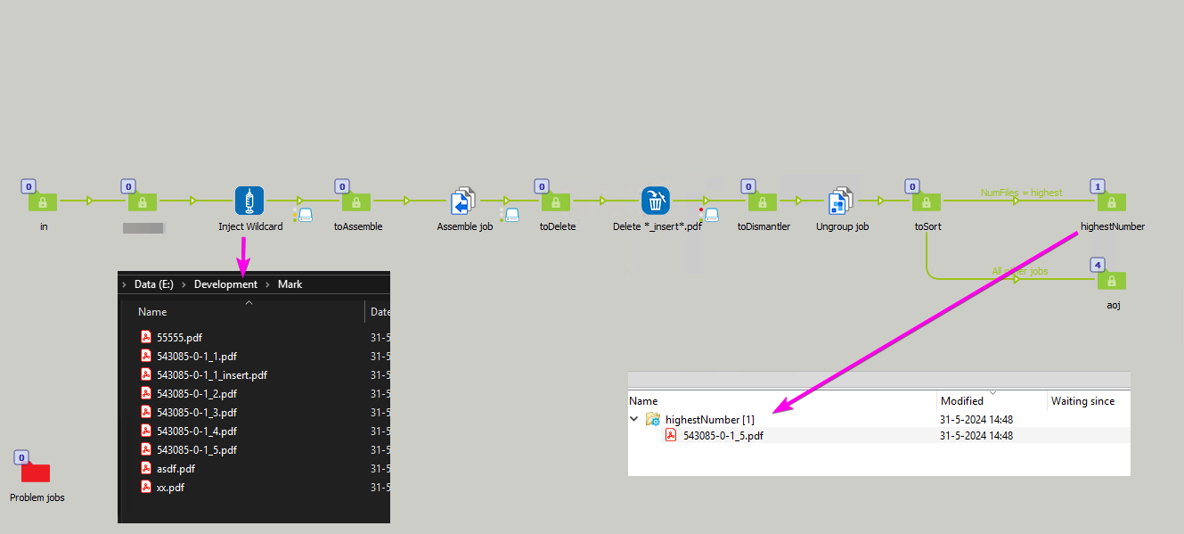

Hello Sander
Thanks for your reply and example flow
Close to perfect but I have a small issue
We dont always have all the old versions in the repository
Example file
543085-0-1_1.pdf
543085-0-1_4.pdf
This then does not match the number of files so both are sent to lower folder
We need to somehow keep the Higher Version number

How about this.
1. We sort the files in the job with prefix count_
2. This is the output, a total of 6 files found.
3. Now we match the count with ungroup.NumFiles. If count equals ungroup.NumFiles than we got the highest number :)
Flow:
https://fromsmash.com/markflow

Perfect, its works, just need to rename the file by removing the Count Prefix, works a treat
Thank you :D
