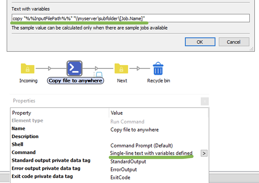

If Set hierarchy and Archive hierarchy doesn't work for your use case, you can do this instead:
Using Run Command. The URL could be any variable that you like. This have also the benefit that the output path doesn't have to be online for you to save and run the flow.
Command (for easy copy/paste): copy "%%InputFilePath%%" "\\myserver\subfolder\[Job.Name]"

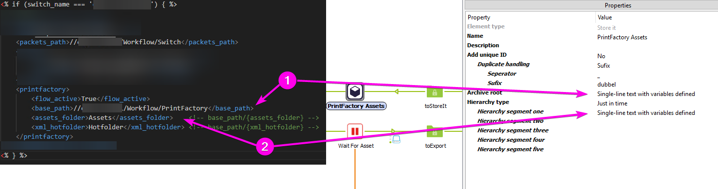

I use the Store it app for this case. I have a couple of Switch servers at different locations, with the same flows, and don't use static paths in flows. Instead I set the path in an xml and pick that up as metadata.
Since 'Store it' required a Hierarchy segment I split the path and feed it like this:
