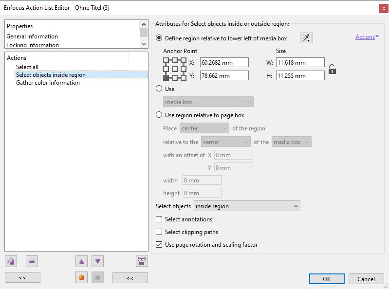

well, I don't have a solution, just a few little thoughts: as far as detecting the background is concerned, you could, for example, use the actions at selected points in the PDF to read out whether and which color is there. The report, called up via the Enfocus Navigator, shows the result on the Color Information page.
But I don't know how you can access the result there in order to trigger further actions depending on it.

Re: Set color of text based on background color
Select text segments
Select overlapping objects - Replace the current selection by objects that are overlapped by any object from the current selection
Select color, e.g. 100C/100M
AND
Log selection - Blue background has text on it
or some variation on the above.
AND
