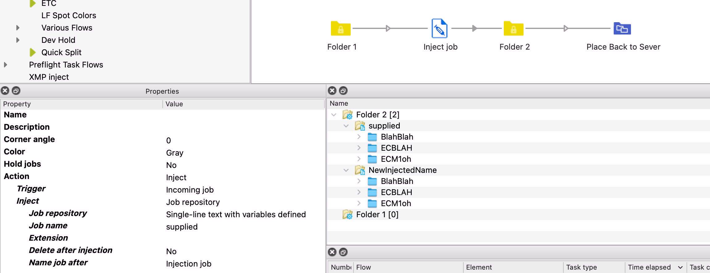

Screenshot attached. Basically the flow retains the existing folders. The folder "supplied" is constant every time and never changes, the other folders are different each time.
I would like to change the folder supplied to another name.
Hope this make sense

Charltonpaul wrote: Mon Aug 19, 2024 5:36 pm Screenshot attached. Basically the flow retains the existing folders. The folder "supplied" is constant every time and never changes, the other folders are different each time.
I'm assuming you have the job number as privatedata? the 602571? If so use inject, set is a a repository, set the path to the root of the job number folder.
eg: /Volumes/JobServerName/[Job.PrivateData:Key="job_number"]
Job Name would be 'supplied'
Then in the Name job after you can use Custom and change it on the inject or once in switch you can use a rename also.
You would also need to set the 'Delete after injection' to Yes.
Here is the result, the first is injecting and not renaming it via the inject, second is the rename using the inject. From here you would jsut need to put it back to the location is belongs to on the server.
