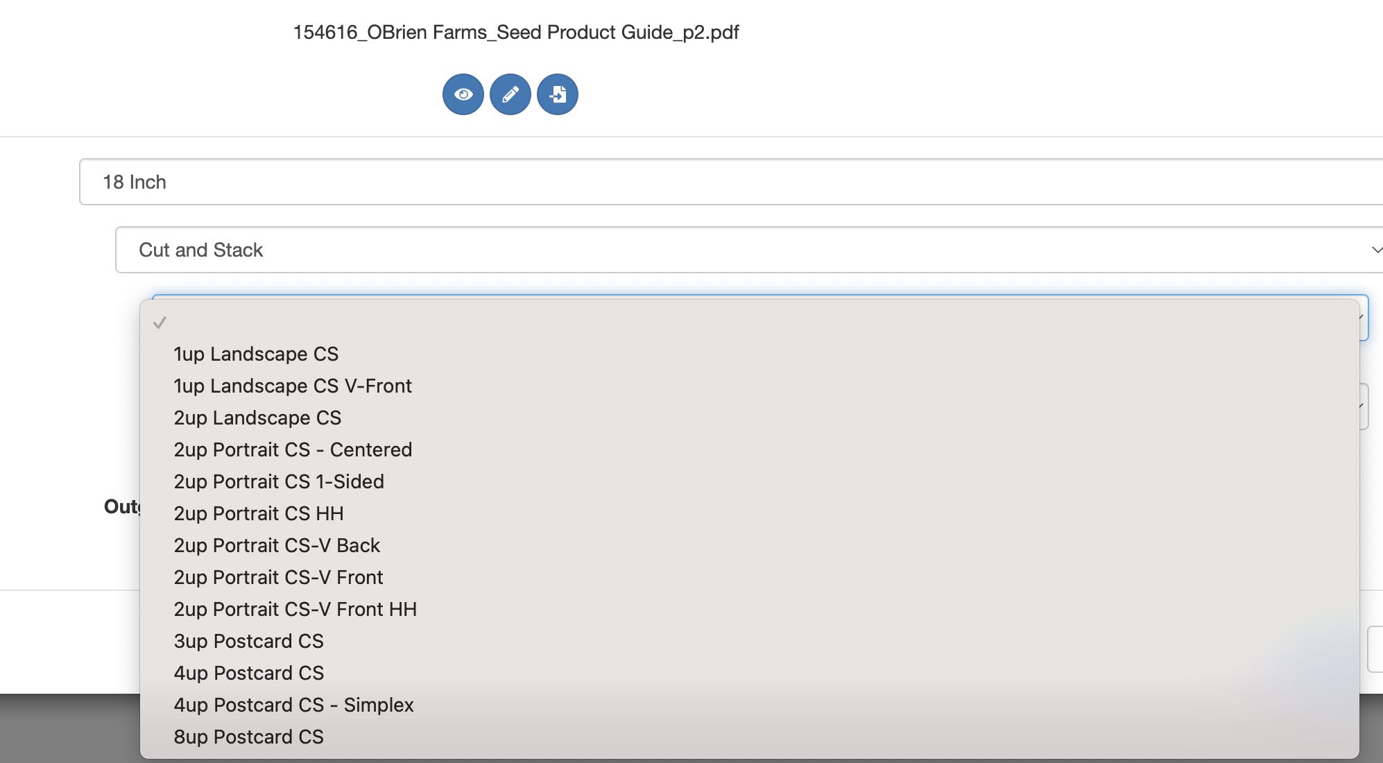

As others suggested, Quiet or Impostrip. I started using Impostrip last year when we got our HP A2200 PageWide Roll to Roll. I'll be honest, I didn't like it at first, but with the super simple impositions we do for the digital roll work it's been better than Phoenix.
The interface does lack, and same within Switch so we don't use any apps in Switch for Impostrop.
We just push xmls or in another flow I wrote a script that reads the location of the various hotfolders, I them grouped by Roll With, then Cut & Stack, Step & Repeat or Bookwork, from there it lists the hotfolders that match the selections and selected the required imposition tempelate.
For example I could have a variable 8.5x11 letter running on 18" roll, I'd select 18"/Cut and Stack/2up Portrait
For Mailing jobs we split by mailing try and apply the correct finishing marks for try offset and eject and end of job and then autoprocess the impostion to the HP DFE via JDF and so on. I also created a checkpoint for jobs we do not autoprocess out that has the simplex/duplex, qty, side a over b, or side b over a, if it's collated etc. Works great!
