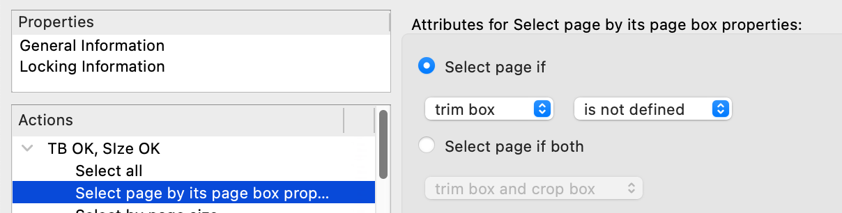

Are you tackling this by the right end?
I get that there are many producers and not all them doing the greatest job. Yet, you should focus on whet are exactly your problems.
For example, if such a producer doesn't create a proper TrimBox, you can simply select pages where the TrimBox are not defined. If they are none selected…fine, next item. If they are any selected, then let's fix them.
You shouldn't be driven by the producer but rather by the individual issues that you can then fix on a more agnostic level. If you really think something can only be tackled by knowing the producer, feel free to share.

It always relates to the fundamentals of PitStop, i.e. Selections.
Your problem is, like I suspected page boxes that in some cases are defined, in other are not. So, what you want is to get all pages without proper page boxes and fix them. That is done with a selection:
If all pages have proper TrimBox, you get nothing selected. And every Action that follows produces no effect.
If you follow that lead, you would see that it's very unlikely that you really need to do things for a specific producer. But once again, happy to be proven wrong.

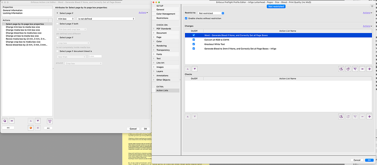

DJS
Posts: 71
Re: An Action list suitable for different "Producers"
Post by DJS »
Quick follow up... have used that action as part of the PPP and all works as I had originally hoped for, thank you very much for all the help and advice
