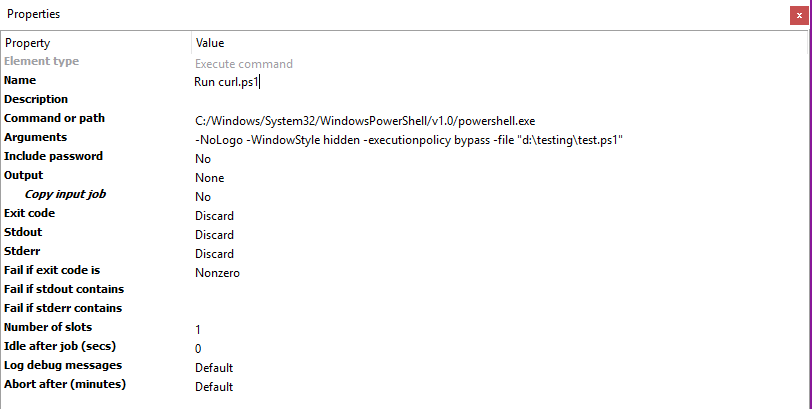

With Execute command you can run it like this:
Edit: changed screenshot, makes more sense now :)

by FrankT
Thank you! this is working for me.

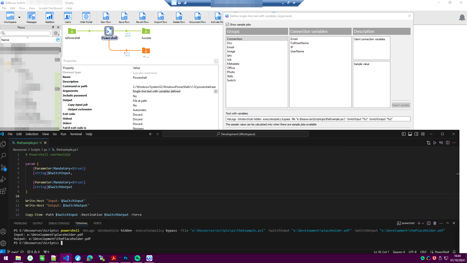

by sander
This is my internal powershell example flow/script, it shows all the magic :)
