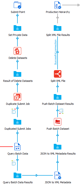

I can think of a couple of ways to achieve this, but I need more info to present a solution. How do the files come into the flow, one folder with all files or file by file etc. Maybe you could post a screenshot of your flow so far?

magnussandstrom wrote: Sun Dec 01, 2024 3:50 pm How do the files come into the flow?
  • Web Submit point sending a dummy file with the Date and Batches MetaData
  • HTTP request to our Data Base for all the Job information
  • It returns JSON to be picked up, and transformed into XML and Split on UID
  • The result is an XML file for each Job, and it's named with the UID field
  • There are more steps in the flow, but the XML file is the final step to make each UID a Job in Switch
I am trying to get our DB admin to order by before they return the query, but I'd still like to have a Switch solution to order them.
