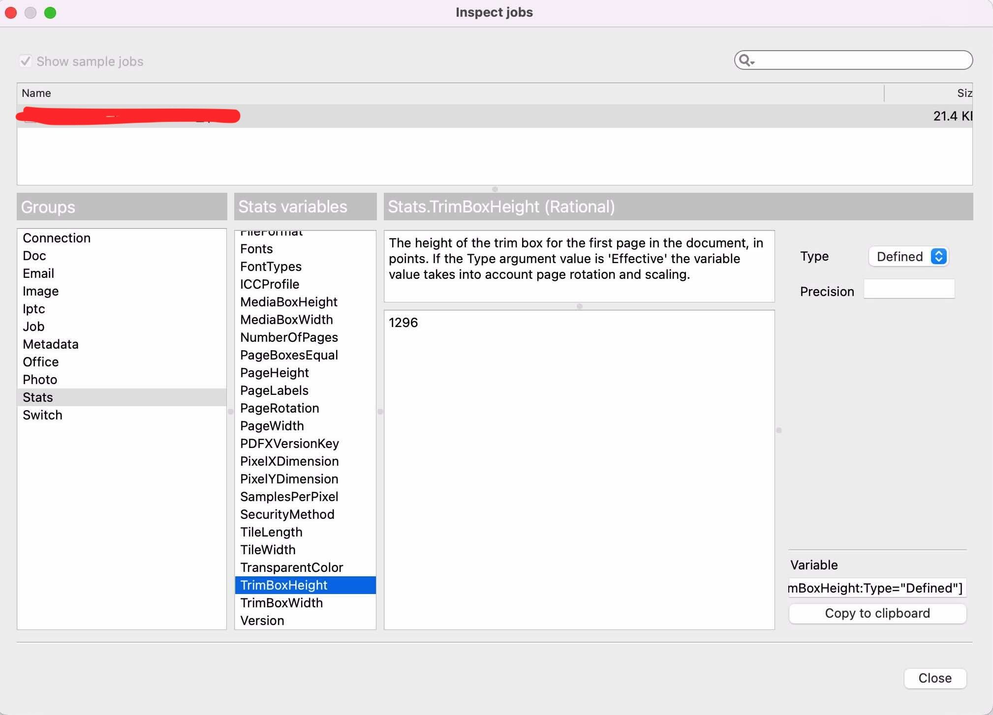

Yes, when you go into the 'Define text with variables' - > Stats -> there are all types of default stats about the file such as Trim Height/Width. It uses Points as the unit of measure so you'll need to do a switch calculation to get it to metric/imperial

I can't do French but I can translate.. Hope this helps! I would suggest watching a few videos on Switch also.
Screenshot 2025-01-06 at 12.39.51 PM.png (69.89 KiB) Viewed 46353 times
Screenshot 2025-01-06 at 12.39.24 PM copy 2.jpeg (180.19 KiB) Viewed 46353 times
