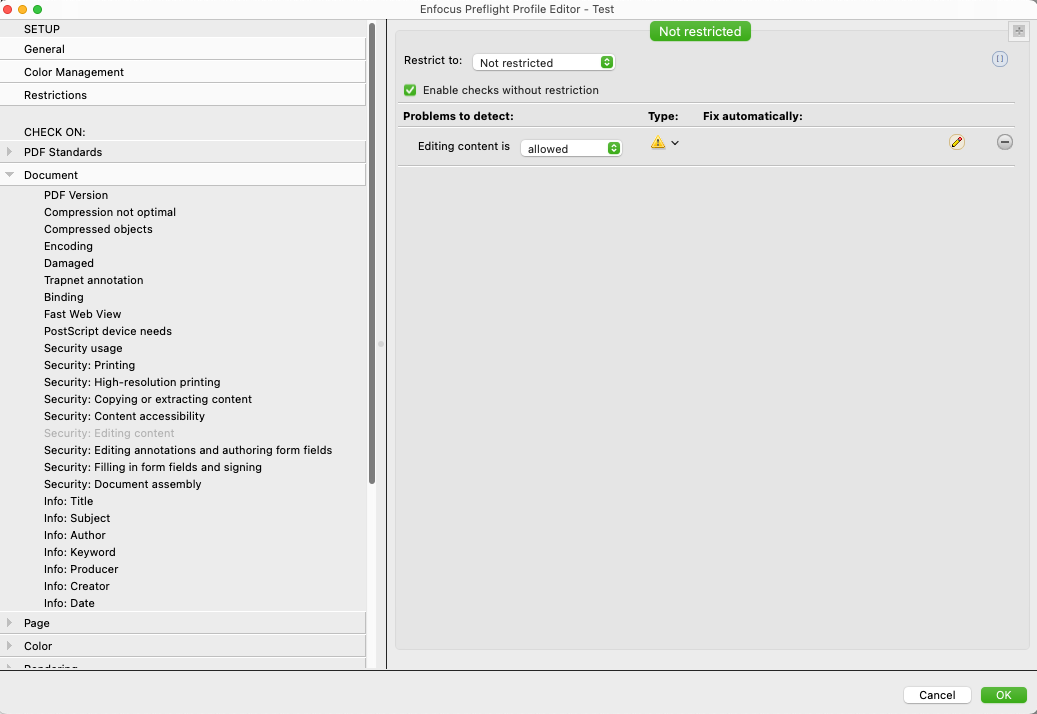

You can use a Preflight to check.
Screenshot 2025-03-11 at 13.23.05.png (98.02 KiB) Viewed 22093 times
