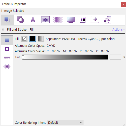

Is there a action list or preflight to Check if any Spot Colour has CMYk values of C 0 M 0 Y 0 K 0 as screen shot attached
Screenshot 2025-03-14 at 16.49.10.png (60.87 KiB) Viewed 38333 times
