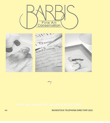

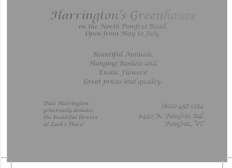

You can see below that in the Yellow separation, that part of the yellow image she created is showing up on the yellow separation. It has densities of yellow greater than the 40% yellow screen.
The reason this was an issue is that I wanted to create a commonly shared yellow plate, and this image was showing up on forms on the press that did not have this image present and you could make it out the yellow impression made.
Yellow Separation only
yellowpage 1_yellow sep.JPG (40.81 KiB) Viewed 175191 times
Black and Yellow
Black and Yellow
yellowpage 1.JPG (191.28 KiB) Viewed 175191 times

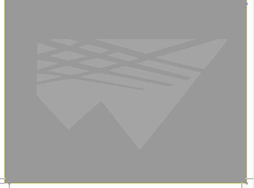

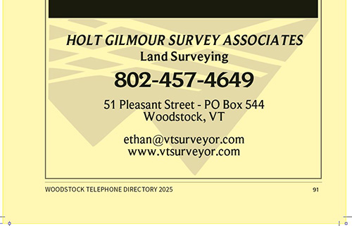

Because she has text and images set to 40% yellow to match the 40% yellow screen in the background (that emulates yellow paper) when I have the action to remove the yellow page and convert everything remaining to black, those yellow elements appear white, which is not what I want.
Below is an image of p. 91 where you can see that an image with a 90% black screen applied to it shows up on the yellow plate. After my current action steps, however, this does not appear to be an issue.
page 91_90 percent black.JPG (22.64 KiB) Viewed 174392 times
page 91.JPG (63.08 KiB) Viewed 174392 times
On Page 80, the outlined numerals "506" contains 20% yellow and 50% black. After my actions are run, the numerals are no longer there and the frame around the advertisement (it has about a 1pt rule around it) disappears.
These are only some examples.

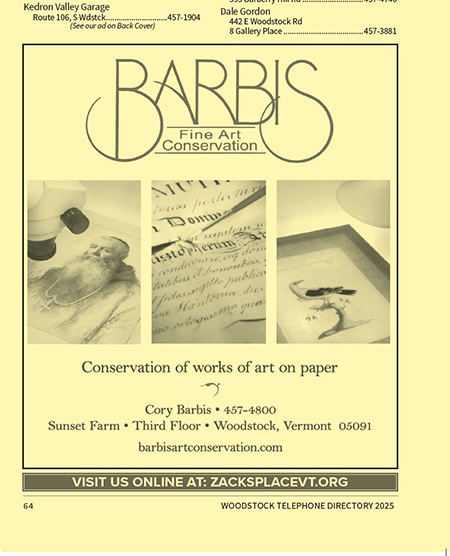

Here is another example of what happens after I run the action steps (See below). On this page many elements disappear and the black images no longer blend with the yellow beneath.

Re: How to remove everything from Yellow Separation
Posted: Fri Apr 25, 2025 6:21 pm
by JimmyHartington

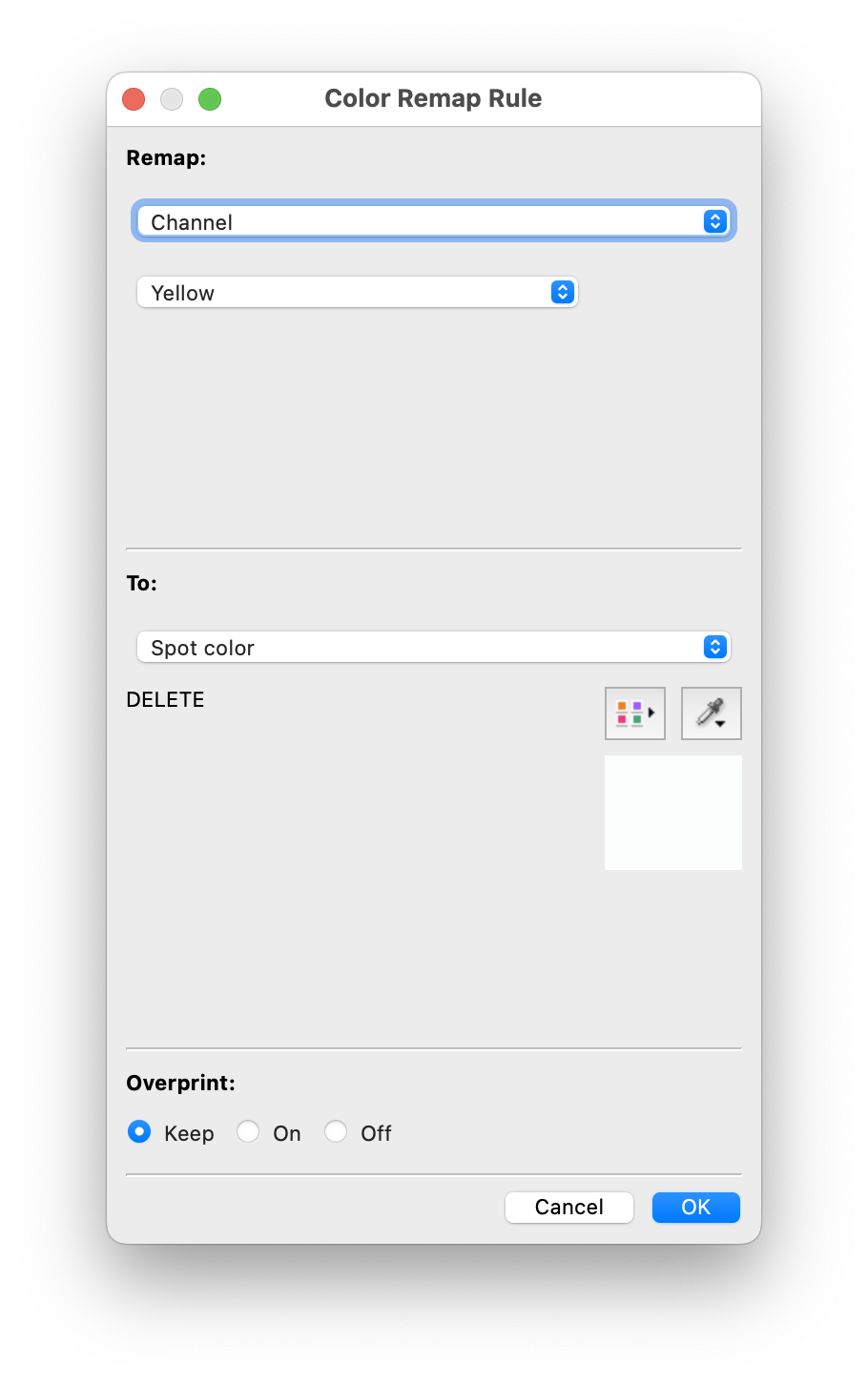

I have made an action list.
It remaps the yellow channel to a spotcolor with alternative CMYK as white.
Remaps this color to CMYK.
And then adds 40% yellow on top with multiply.
You can find the action list here: https://github.com/jimmyhartington/pits ... tiply).eal

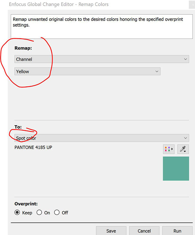

I am attempting to deconstruct/comprehend how this works. I recall someone, maybe yourself, saying earlier to remap the yellow channel to a spot color. Does it matter what spot color or just any spot color?
What is the alternative CMYK? Are those the white elements that were in the file? Are you then remapping the white to cmyk?
I am using an older version of Pitstop, but I believe I am in the correct place to perform the actions you have described.
Posted: Tue Apr 29, 2025 11:04 pm
by JimmyHartington
The trick I used is to remap the yellow channel to a spot color.
This spot color has to have an alternative CMYK value of C 0%, M 0%, Y 0% and K 0%.
Because the next step is to remap this spot color back to CMYK. So the spot has to be white.
Last bit is to then add yellow rectangle on top with multiply (should also work if overprint fill was set to on).
Acrobat-megatrade.staging.dynamicweb-cms.com-2025-04-29 at 23.05.26@2x.png (245.96 KiB) Viewed 154875 times
