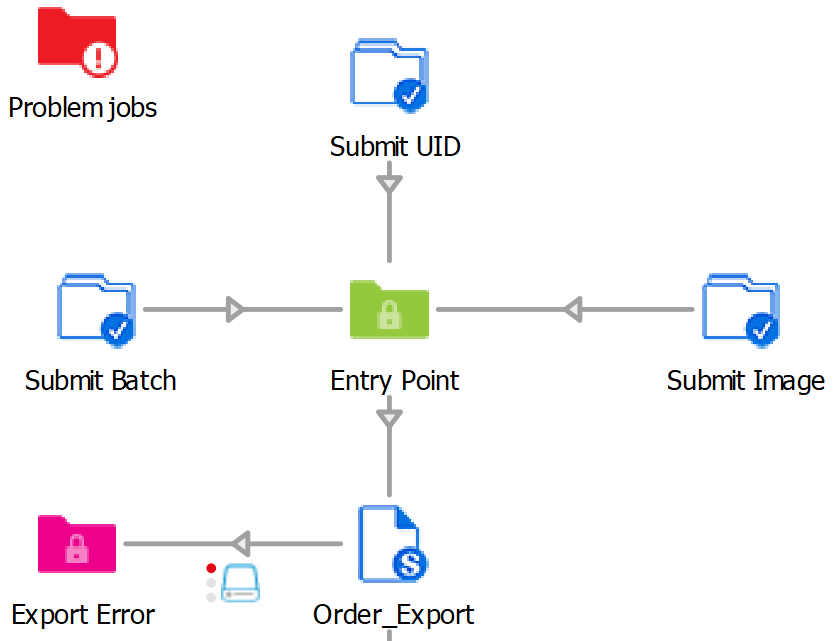

Hey all,
I am not sure if this is the way to go about it or if there is a better alternative.
I have three different Submit points that go to 1 flow, each with their own properties and purpose.
When the Job arrives at "Order_Export" How can I determine which Submit point the job is coming from? Maybe there is another approach to this situation that I am not aware of that would be more of a standard practice? I was thinking of making only one submit point with a lot of conditions to make the Submit point more dynamic and handle all 3 roles but that seems like a more complex workaround. Any guidance or input on this would be greatly appreciated.

You could add a hidden field like "Submit Point ID" that you could later use in the flow?

Can't you use the Dataset name?
You could also add a folder after the Submit point where you add a Private data to the job identifying the Submit point.

I will suggest the same idea as Loïc.
It would look like this when you configure the submit point:

loicaigon wrote: Wed Apr 23, 2025 5:28 pm You could add a hidden field like "Submit Point ID" that you could later use in the flow?
This is a good Idea. What I have decided to do is they all have the same "Submitted_Data" Dataset, and each one has their own SubmitPointID. So now in my script I can always get the SubmitPointID and get ID specific values to use in my flowcontrol! Thanks again for the suggestion, it really helped alot!

JimmyHartington wrote: Thu Apr 24, 2025 7:40 am I will suggest the same idea as Loïc.
This is the route I took. Thanks for confirming the idea. It pretty solid and is working great!
