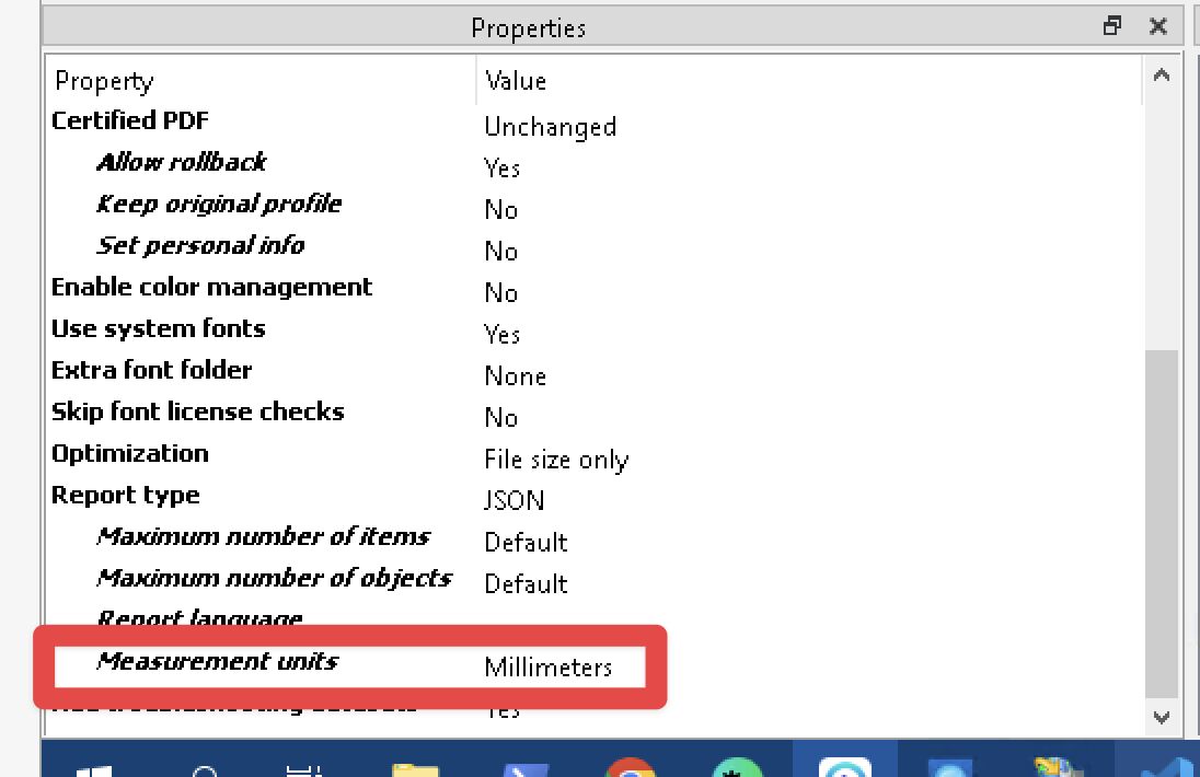

Have you set the units to Milimeters in the Pitstop Server Configurator?

Yes everything is in mm. but still it puts the grummets on the wrong space. I put in 300 mm between the grummets but he places them round 150mm (see exemple)
