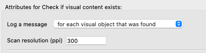

I think that it's normal to some extent. Before the page is scanned, it's actually rendered as an image. So that's 90 pages rasterized (internally) to the resolution you have set.
Screenshot 2026-03-24 at 15.52.13.png (10.38 KiB) Viewed 15858 times
Higher resolution may increase detection but also time.
Lower resolution will speed up things but may reduce detection capacities.
So it's a choice between delay and quality.

Thats makes sense why it takes quite a while to process.
Thanks for explaining this, I will try the Resolution at 100dpi
