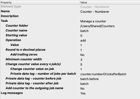

Hi Jason, there's an app for that: Counter - Numberer
No need to assemble, and no need to wait or release jobs.
