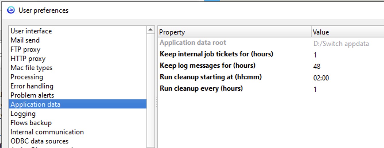

I assume that the cleanup for processed tickets is set for keep too long.
We also had this issue (like restarting took too long), see screenshot.
FYI: Cleaning these tickets are only for processed files, so logs are still available after 48h.
Scherm­afbeelding 2025-12-03 om 12.09.23.jpg (105.03 KiB) Viewed 15415 times
