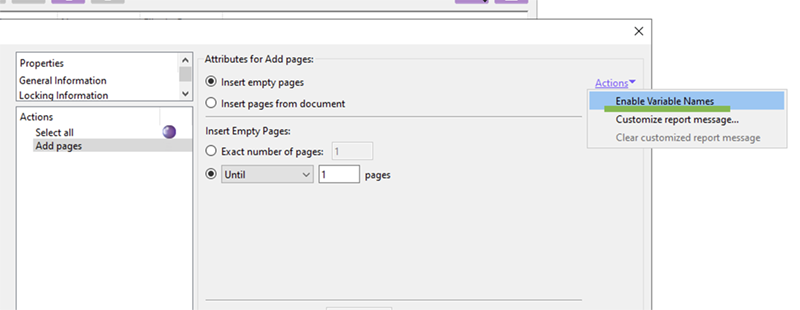

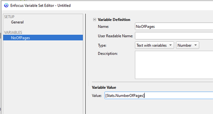

You already have access to the number of pages in a PDF as soon as the file is picked up by a Switch flow. This information is available via the metadata variable [Stats.NumberOfPages], so there’s no real need to extract the page count from the file name unless you specifically want to.
However, it’s not possible to use Switch variables directly inside a PitStop Action List. To make a Switch variable available in PitStop, you need to pass it through using a Variable Set.
To do this:
1. Select a PitStop Server Configurator in a Switch flow
2. Go to Variable Sets and click New
3. Create a new Variable Set (it can contain multiple variables)
4. Add a new variable and set Type to Text with variables
5. In the Variable Value field, insert your Switch variable (for example, [Stats.NumberOfPages])
Now go to your Pitstop Action > Actions > Enable variable Names
Once this is set up, the variable will be available for use inside your PitStop Action List.
