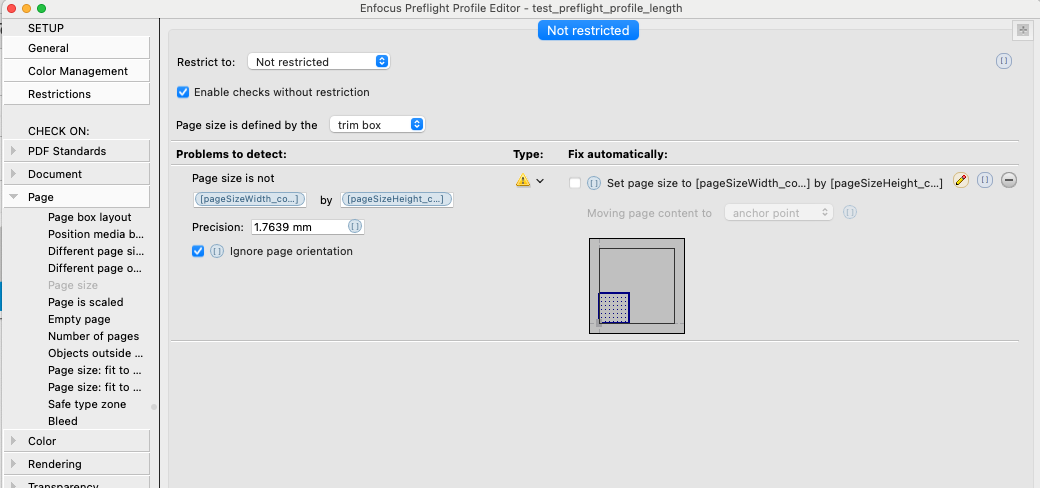

But of course, it's also recommended to add the size check in the Preflight Profile:
Screenshot 2026-02-25 at 17.50.40.png (25.28 KiB) Viewed 5341 times
Screenshot 2026-02-25 at 17.47.04.png (80.24 KiB) Viewed 5341 times
