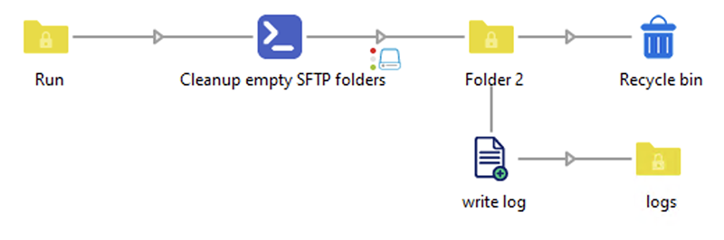

I built a small program (Windows only) to use in a Switch flow that you can try out if you want (at your own risk of course):
Download here: https://tinyurl.com/3jwyjpe8
Just edit these variables in the Run command-app and you are ready to go:
"C:\yourpath\cleanup-sftp.exe" --host sftp.server.com --user username --password "password" --root "/" --min-age-minutes 1
Info:
The --min-age-minutes parameter is for preventing the deletion of folders that just have been created. But if mtime is not provided by the SFTP server you need to set it to 0 for it to work.
--root "/" means the root for the specific user, if you want you can set it to another directory like --root "/subfolder1/myfolder"
To run the check every 60 min I would suggest to add the Switch app FireStarter in the beginning of the flow and set it to 60 min.
The log folder is just a suggestion and can of course be deleted if you want to.
It works good for me, but please try on a test root folder first to ensure that the behaviour is what you are looking for.
