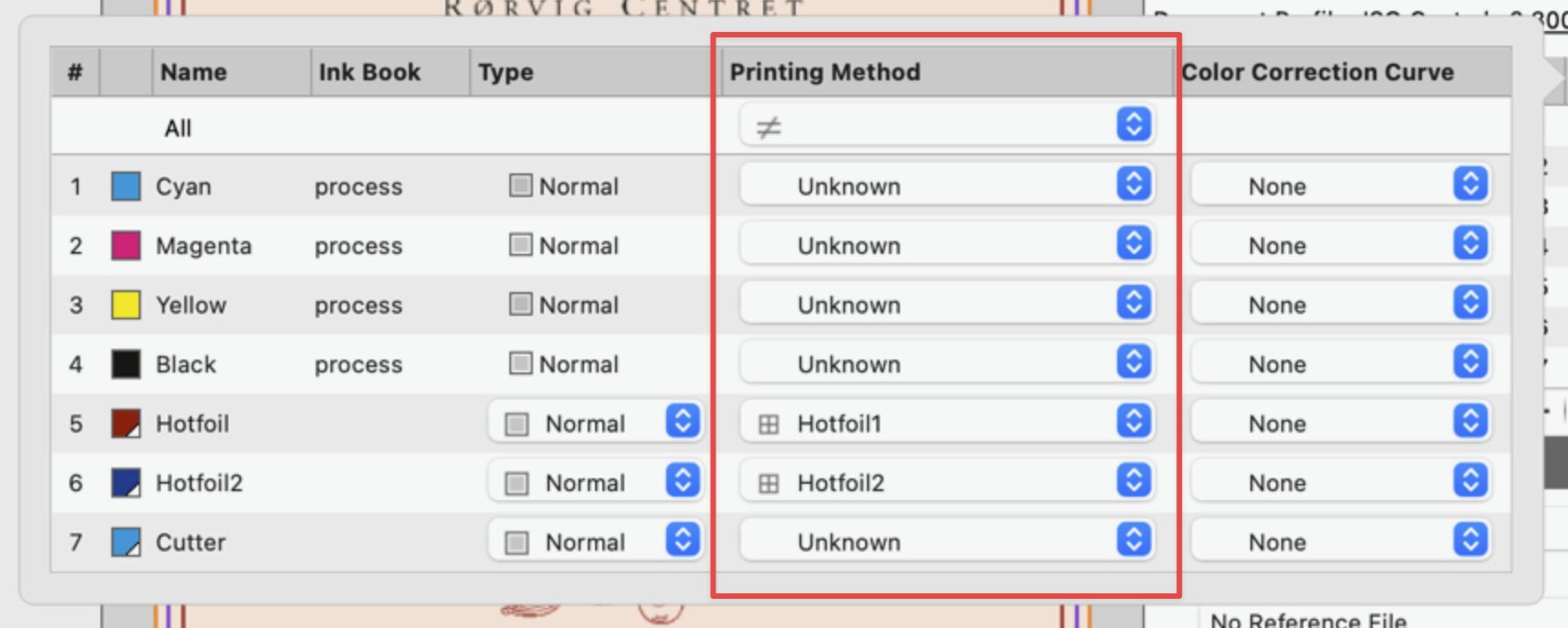

In Switch I receive files for label production from a customer which has Esko ArtPro+.
The set the printing method for some colors in the ArtPro and then saves and send the file to us.
But I can not find a way to extract this information. And I do not even know if is saved into the pdf.

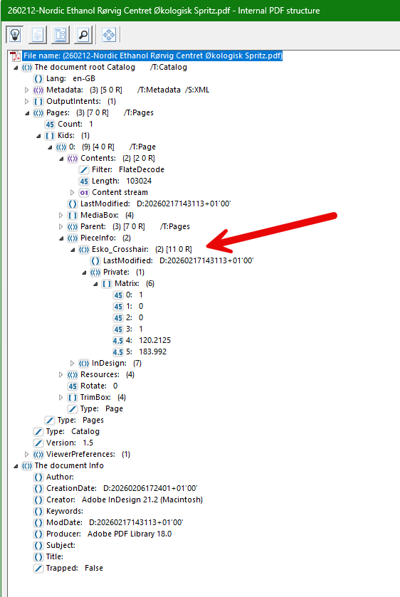

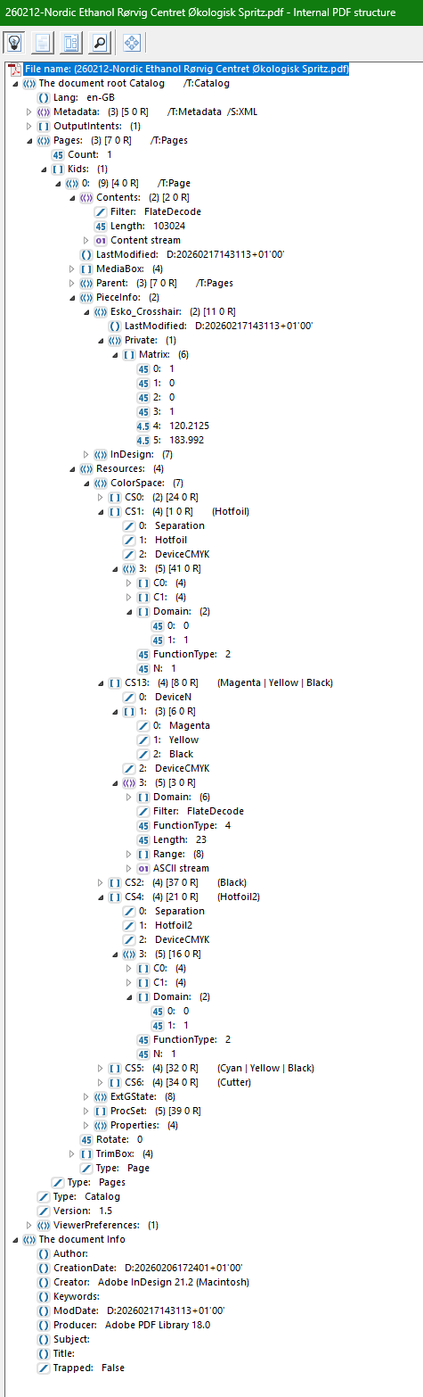

Re: Extract data from pdf from Esko ArtPro+
Posted: Fri Mar 20, 2026 2:22 pm
by jan_suhr
PDF Toolbox have a tool for exploring the metadata inside the PDF.
The only thing I found from Esko or ArtPro was this crosshair, not trim marks as I said before.
Nothing special in the color definitions
