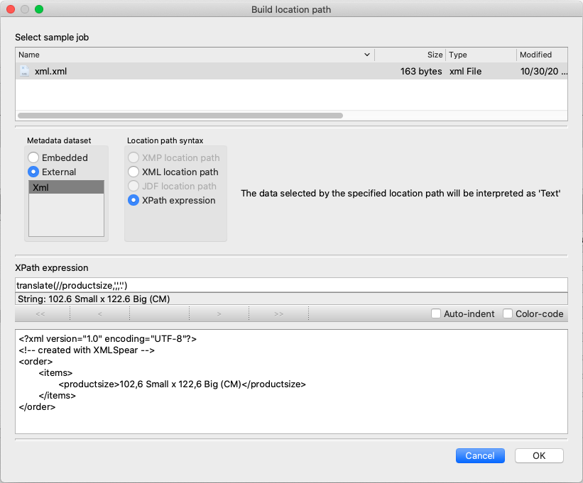

This is something you can do directly in the XPath with which you get the info from the XML using an XPath function:
Screen Shot 2020-10-30 at 15.35.00.png (76.96 KiB) Viewed 34348 times
The XPath expression is perhaps not so readable in the image:
translate(//productsize,',','.')
