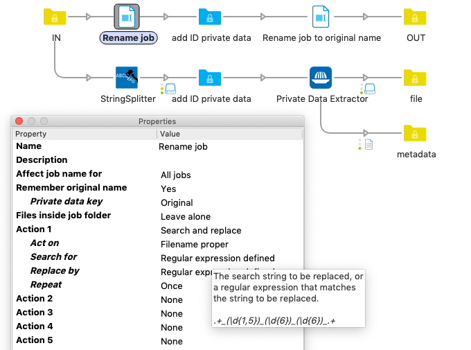

You can not do this in one go, but here are 2 solutions:
Rename the job to the part you need using search and replace regex:
Search for regex .+_(\d{1,5})_(\d{6})_(\d{6})_.+ and replace with regex \3 (third captured string)
Set private data ID to the job's name: ID=[Job.NameProper], that's the info you need.
Rename the job back to its original name.
Or, more straightforward, use StringSplitter app.
https://www.enfocus.com/en/appstore/pro ... ngsplitter
