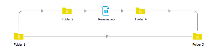

Can't you just do like this in Switch:
Re: copy with Process.execute
Posted: Thu Jan 14, 2021 8:58 am
by hover27
@jan_suhr
no, that is not what I need.
I need to copy two files together.
That is only possible with the internal command copy.
With the parameters of copy, I can copy two files into one file.
That's why I need to do it with Process.execute() and the copy command.
