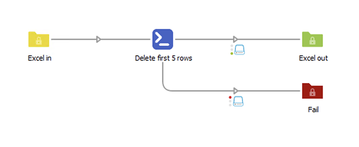

Please post here if you get stuck on the Run Command "Command" for Easy Data Transform, It was a bit tricky to get it to work initially.
- magnussandstrom
- Advanced member
- Posts: 570
- Location: Sweden
- Contact:
Re: Remove rows from CSV
I made a Switch flow and an 'Easy data transform preset' that removes the first 5 rows. You can edit it and change file format to fit your specific case.
Download (avaliable for 2 weeks): https://bit.ly/3Lp8eQ8
Example of Run Command command: "C:\Program Files\EasyDataTransform_1_44_0\EasyDataTransform_1_44_0.exe" "\\URL-to-preset\preset.transform" -file "Input=%%InputFilePath%%" -file "output=%%OutputPath%%\[Job.NameProper].xlsx" -cli
