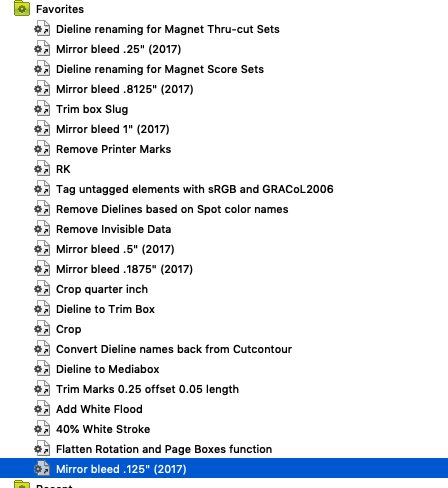

Screenshot of Action Lists Favorites

Several co-workers have complained about the same behavior. I have tried creating groups in hopes that it will make sorting easier, but this causes Acrobat to crash aggressively. After creating a group in Favorites, and dragging a dozen Action Lists to that group, Acrobat suddenly started crashing 100% of the time that I tried to drag-and-drop an Action List in the Action Lists window. It got so bad that I had to close out of Acrobat, find the filepath for my favorites (/Users/[user]/Library/Preferences/Enfocus Prefs Folder/Favorites/Action Lists/PitStop Pro 19), move all of the actions out of the group (folder), then delete the group from Finder. Only then was I able to use Action Lists again without constant crashes.

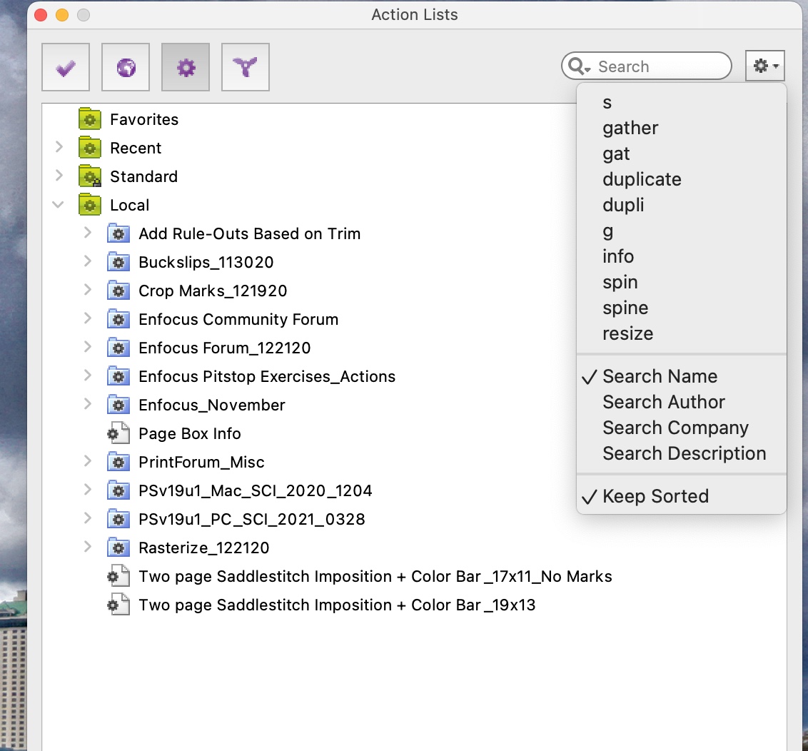

Post by CruzinCooler »
Go up to the search window, the magnifying glass and select the tiny arrow and scroll down to Keep Sorted
