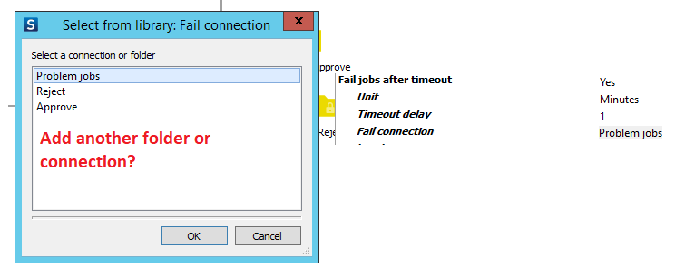

I saw the properties. There is "Fail jobs after timeout." According to fail connection, there are only three connections: Problem jobs, Reject, and Approve.
Is it possible to add another folder and/or connection? If so, would I have to add another folder to the flow and would the new folder be shown on the list? Because if I pick Approve or Reject, the file would be approved or rejected automatically, which I do not want. I want the file to go to the customer for them to approve or reject again, if they haven't done so.

The list of available folders for the reminder is dependent on how you have setup your PDF Review App, it will show the connections that are there on this one. Yes add another one and it will turn up in that list.
