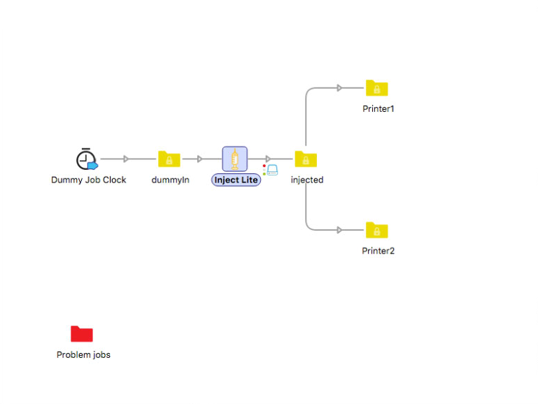

You can do this with a couple of free apps. Use Dummy Job Clock to inject a dummy file into the flow at whatever interval you need. Then you can use Inject Lite to pick up your print file from the static location, and copy it to the printers. It would look something like the attached image.
- Screen Shot 2020-01-22 at 9.59.28 AM.png (60.22 KiB) Viewed 11555 times

"Dummy job clock" is not suited for the described use case because it starts injecting every time you start the flow. You have to use the regular "Inject job" element and configure it like this. There is NO input folder. On the OUTGOING connection you set "Trigger" to "Time of day" and define the desired time of day and you inject a specific job without deleting it. When you start the flow nothing will happen until the configured time of day is reached, which could be tomorrow.

Hello Freddy,
Thank you so much for your reply.
Your assumption was good and not mine for sure.
Because I forgot two main things.
The first one to point a specific job and so far I did it with a folder instead.
The second one to avoid deleting job after it has been injected.
I just tested as you explianed; so far so good.
